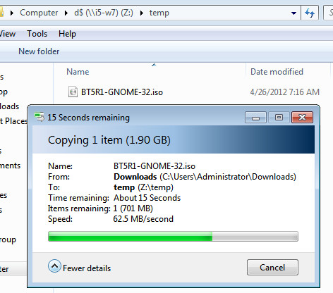

Here is a push from the VM itself to my workstation. This is from 2k8r2 storage essentials vm, seems to be pushing a file just fine.

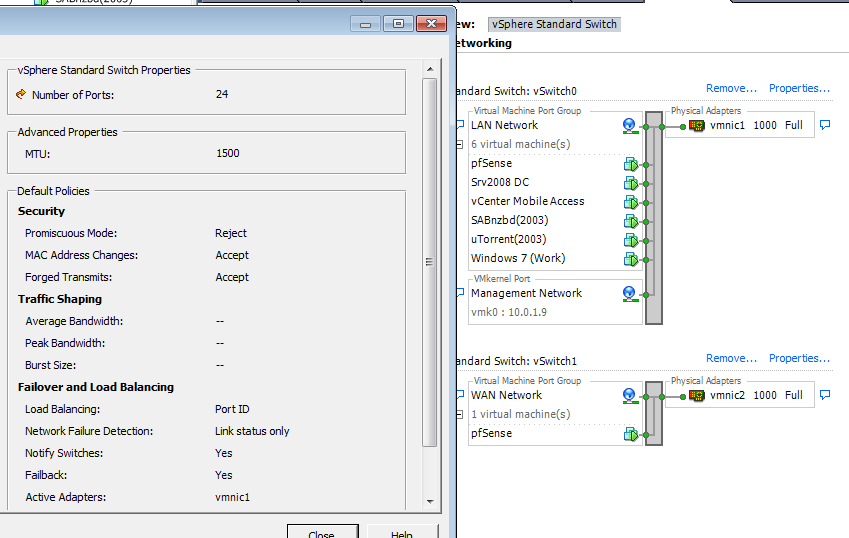

Are you still 9000 mtu on your virtual switch? Do you have promiscuous allowed or something? Traffic shaping enabled?
You don't have your VMs in your management port group do you?

index.php?app=core&module=attach&section=attach&attach_rel_module=post&attach_id=310055

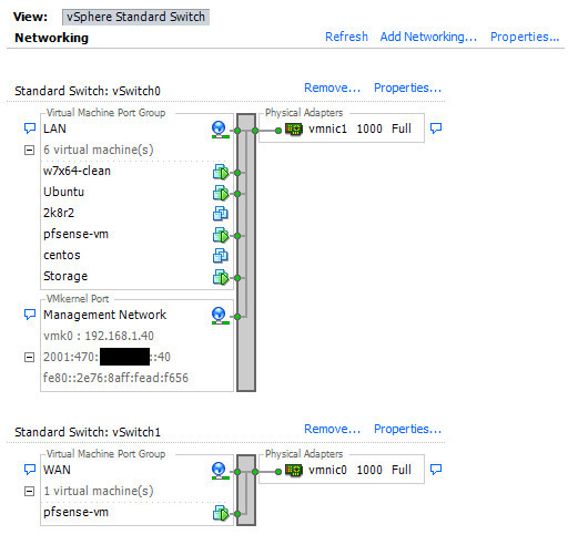

As you saw I am getting great performance from my vms -- and other than the nic itself I don't see what could be different. Other than just overall bad performance of the drives or vmfs? What if you do iperf between vms -- what do you see then?

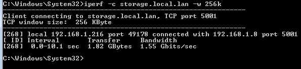

So you only see 300Mbps between vms testing with iperf?? Something wrong there for sure.. See my 1.55Gbps

No I didn't mean vmxnet3 for trying other one.. I mean what physical nic is tied to each virtual switch.. I have the built in one connected to my lan vswitch. And the addon nic is connected to my wan vswitch. But again that shouldn't have anything to do with vms talking to each other over the vswitch - it shouldn't You could always remove the nic from the vswitch as a test.
