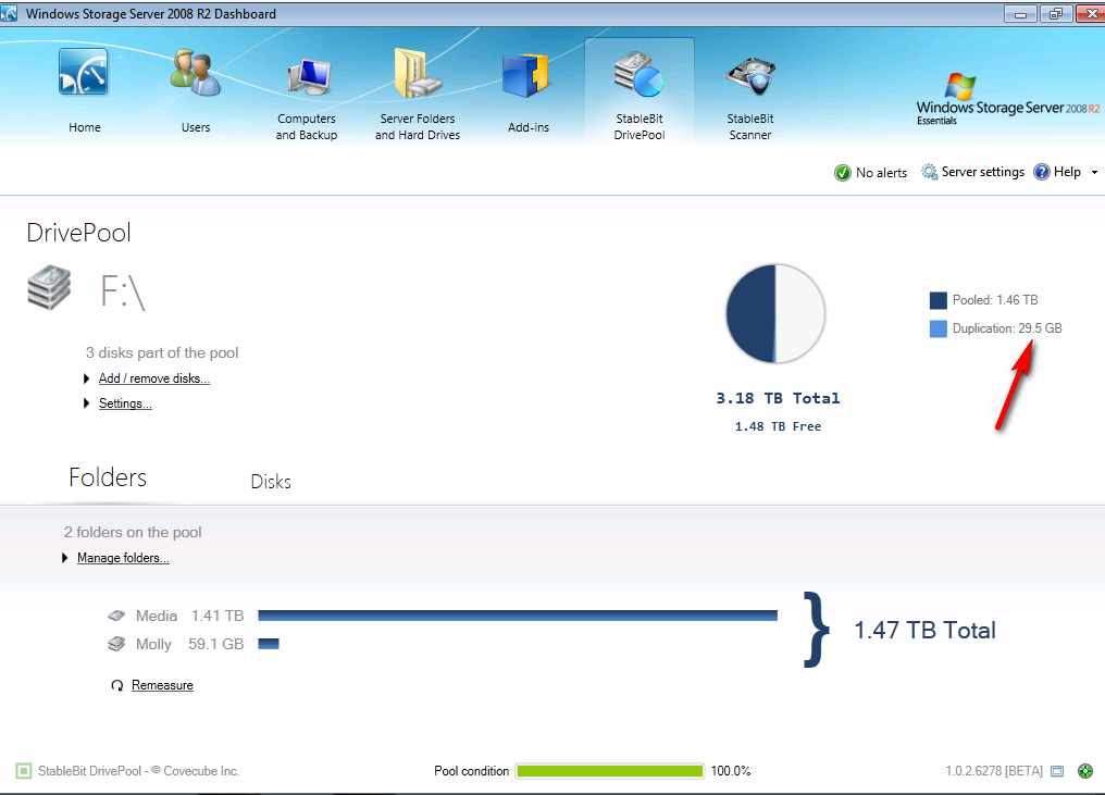

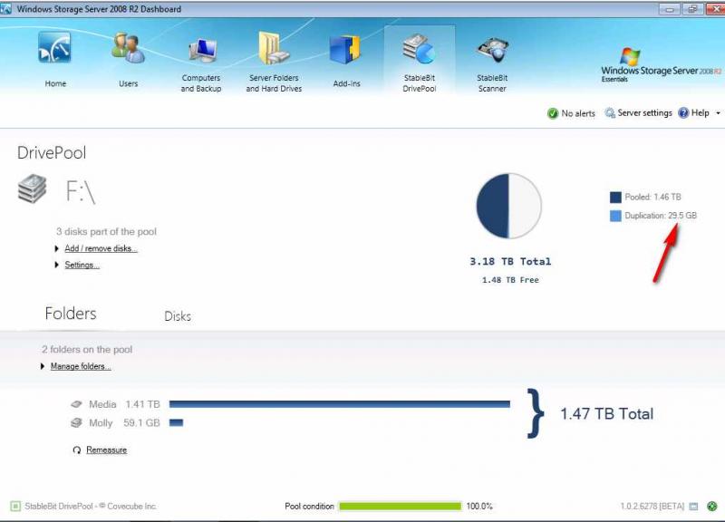

Just thought I would mention how I am handling my storage on my N40L
I am running 2k8r2 essentials storage server (big brother of WHS) And the drivepool addon - http://stablebit.com/ in a virtual machine. I then have RDM of the drives to this VM.
Sweet thing about the addon is that allows you to create pool of all your storage without having to worry about any sort of raid. And allow you to expand on the file - no need for same size or speed of disks, etc.
So for example I have a 2TB, a 2x 750 all in one pool. So it adds up to like 3.18TB -- now for safety reasons I have my grand daughter vids duplicated (copy on more than one disk).. This is not my backup!! This is just so if I loose a drive in the pool I don't have to worry about recovery those files from backup - which they are (in multiple places!)
post-14624-0-08230800-1340653945_thumb.j
If I want to add more space, just connect another disk - with the N40L I can add 2 more drives for a total of six. But my current plan is to wait til drives come down in price and then swap out my 750s for bigger drives. Its as simple as remove drive from pool (will need enough space free to move the files off of it in the pool). Then just replace with newer bigger drive and it will the redistribute the files across the pool.
I just don't see the need in home setup for the overhead of conventional raids. Now I have looked into the ZFS pool stuff, and it is slick stuff. But you might want to read the details of adding more space - you can not just add one more drive to the pool. Say you have a raidz setup with 3 drives in 5, to add more space to the pool you would have to create another raidz with 3 more drives, etc. It is SLICK, don't get me wrong!! But in the home setup, I would go with unraid setup or what I am doing. I would like to go with unraid as my space requirements grow - but I was able to accomplish my goals on a very cheap budget by leveraging the drive bays of my N40L and just using a VM as the frontend to the drives.
Since I can add 2 more drives to my N40L, and not counting the drive I am using for my VMs datastore - I can have like 5 drives in one large pool or 5x3TB say for 15TB of storage - with the ability to duplicate my stuff across multiple.. Shoot even if I just limit myself to the 3 actual bays of the N40L using now - could go with 4TBx3 if really needed space for 12TB.
And as you saw from the performance thread -- able move files on and off this pool with no issues at very very good speeds.
edit: Another nice thing about the drivepool addon, is I was able to add the drives with their files on them, no need to wipe the drive or anything when added to the pool.. And then just moves the files into the pool, etc.
