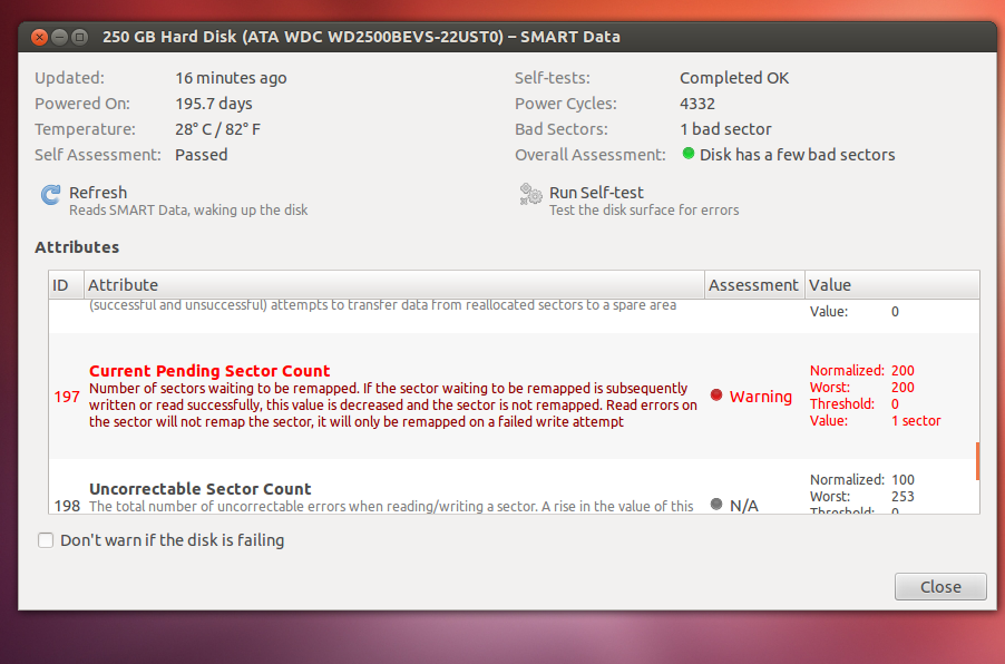

It sounds like your hard drive may be developing problems. Is Ubuntu installed on the same hard drive or a different one? If its on the same one, is it slow to boot or does it report any disk I/O errors?
In Ubuntu, open Disk Utility, select your hard disk, and click "SMART Data". That should tell you whether the hard drive is physically having problems (most likely developing bad sectors by your description), or the issue lies elsewhere. Particularly pay attention to the "Read Error Rate", "Reallocated Sector Count", "Seek Error Rate", and "Current Pending Sector Count". Those are the most likely attributes to indicate a problem. DON'T GO BY THE OVERALL ASSESSMENT! It will often say "Disk is Healthy" unless your disk is in VERY bad shape.
Also, testdisk is an expert tool. You definitely shouldn't be using it if you're not sure EXACTLY what you're doing. While it can be used to recover from complex failures, it can also very easily be used to cause damage that is difficult to repair.
You're right Hum; I forgot the OP said it is a laptop. He may have two hard disks in his laptop, but its very unlikely. I should have assumed that Ubuntu is installed on the same disk as Vista. Consider my previous post amended accordingly. (I can't edit it anymore.) My main point and instructions are still valid, though. In context, its a fairly trivial detail.
Bad sectors are "reparable" in some cases. Your hard disk has a reserved area where a very small number of sectors can be remapped. However, if a sector cannot be remapped, either because the reserved space is full or for some other reason, then its time to backup your data and get a new hard drive.
Try running HDAT2 to repair the bad sector. After it completes, reboot back into Ubuntu and check the "Current Pending Sector Count" in Disk Utility again. If it has dropped to zero, make sure there are no other errors reported by SMART, and try starting Vista again. Even if all the bad sectors have been repaired, its likely you will have to run chkdsk on your Windows partition before it will boot.
Thanks for your help! Here's the result of Disk Utility...looks like bad sectors. Is this the end for my laptop? Will the Ubuntu side die eventually too?
You should really back up your data ASAP. The more you use the laptop the more bad sectors you're going to get.
Back up the data onto a USB drive or something similar. Ubuntu & everything else on the hard drive will eventually be unreadable.
The laptop itself is fine, you'll just need to have a new hard drive installed & then re-install Windows/Ubuntu from scratch.
It is definitely a good idea to backup your important data - which you should be doing regularly anyway - but a couple of bad sectors does not automatically mean the end of your hard disk. It is sometimes possible to remap bad sectors and for the disk to be completely usable for years after. However, the fact that your disk somehow developed bad sectors does make it more likely that you will get more, even if the ones you have can be remapped. If this is your primary computer, I would recommend preemptively ordering a new hard drive for it. Otherwise if you don't rely on it every day, I would wait to see if the sectors can be remapped before ordering a new disk.
