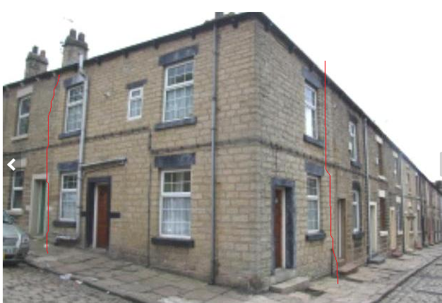

plus neighbours on both side, they just don't seem the sort. probably sounds silly lol - my house is within red lines - point is, it's not a busy street :/
