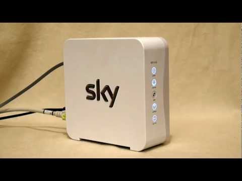

I have a new sky hub for fibre broadband
It has a WPS button on the front
this is out in my hall
i have this one
this also has a WPS button
I want to plug this into my sky tv box using a ethernet cable
now if i press the WPS button on the main router, turn the DHCP off on the router plugged into the sky tv box and press its wps button will they auto connect wirelessly?

NO...
If you going to connect them via wire, why do you need/want them to connect wirelessly?
1 person likes this
Share this post
Link to post
Nah like this
I cant get a wire from the main router to where the TV is without a whole lot of hassle
Share this post
Link to post
that is not what WPS does.. Your going to want that router connecting to your main router that has internet access to be a client bridge sort of connection.
Its going to have to support that.. Can you put 3rd party firmware on the client bridge router.
I doubt your wps button an your router is a enrollee (client) your router is going to be a registrar (allow clients to connect to it).
You do know that WPS was compromised a while back, 2011 -- safest option with any sort of WPS is disable it!
I would suggest you wire them, if you can not run a wire - what about using homeplugs, plug into power outlet at one end connect to your switch with ethernet cable, plug in another homeplug at power near other connection and plug in your ethernet cable.

If he is using the routers as AP, ie turning off their dhcp and putting an IP on the lan that is on his main routers network, and connecting them via lan port to his network via wire then no there is ONLY the nat at the pubic internet connection. His other wireless routers are just Accesspoints and switches.

This is possible, but as Budman said you'll have to use 3rd party firmware for it (I know for a fact that OpenWRT supports this very setup, I investigated it for making my old WRT54GL useful again)

Having the routers talk to each other via WiFi, you want to bridge the network over the wifi link and most routers (I'd imagine) don't support that in their default firmware.
And if you want broadcast traffic and such to work you'll need to run repeating stuff on each router, normally that stuff (like DHCP) doesn't cross the network barrier.

Yep, wireless bridge is what you need, Some routers actually support this. TP-Link Routers can do this as I have this same setup at my church. Which extends to two more routers (the two routers are hooked up via a wire however)
My setup: TP-Link Wireless Router ----(wireless)---> TP-Link Wireless Bridge ---(Ethernet) ----> Linksys Router --(Ethernet)---> Linksys Router
Because our two buildings are separated, we're planning on getting a fiber connection between them to avoid drops and improve speed at the church as the internet is hosted at our second building next door.
To avoid confusion however, I have the one Wireless Bridge at my church using a different SSID than the one at the house.
