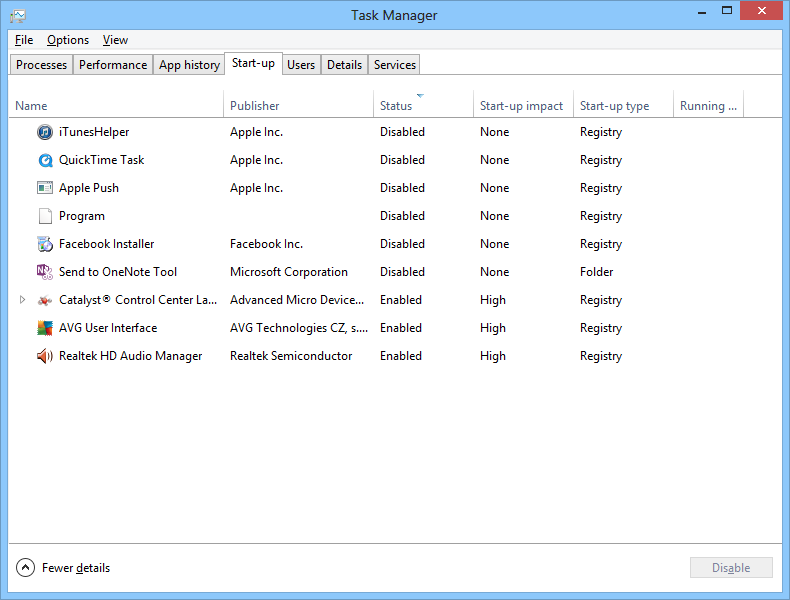

I have you installed any new updates/software or made any other changes?  Take a look at Task Manager>Start-up and see if there is anything starting that shows as having a High impact on start up.

No I haven't that's the odd thing. The system is clean of viruses and malware, and while I had to repair an Office Install I've added no new software in weeks. Most the entries in start-up are standard stuff, as follows:

Start-up looks pretty clean and looks like you've already disabled stuff you don't need so all good there.  Take a look under the Action Centre (Left click the flag icon in the taskbar and click "Action Centre") and expand Maintenance and view the reliability monitor is there any drivers/programmes that might not be shutting down properly that would stop hybrid boot from loading correctly at start-up? Also it's worth looking in the event viewer to see if anything is being flagged there.

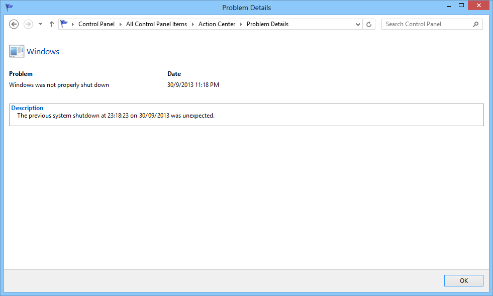

I've looked into the reliability centre, and while there are few "Windows did not shut down properly" errors it doesn't really say what caused them:
#8 AStaley
AStaley
    Neowinian
  • Tech Issues Solved: 4
  • Joined: 07-August 04
  • Location: United Kingdom
  • OS: Windows 8.1 Pro x64, OSX Mavericks, Elementary OS, Server 2008 R2/2012 R2, CentOS.
  • Phone: iPhone 6 (IOS8)
Posted 02 October 2013 - 18:59
That's not the windows I was referring to, within Action Centre under the maintenance section is an option view the reliability monitor.  You can also type "Reliability" in to the Start screen and it will appear under options which should give you more information.

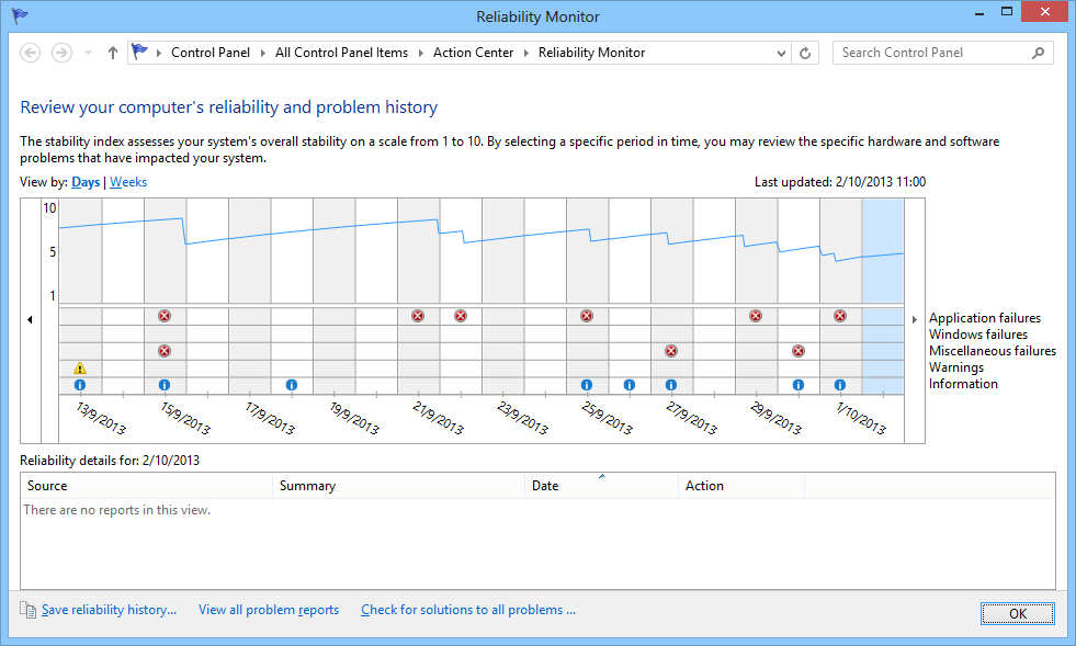

#11 OP Richard C.
Richard C.
    The Cooky Monster
  • Joined: 15-April 05
  • Location: Around
  • OS: Windows 8.1 Pro & Mac OSX
  • Phone: iPhone 5
Posted 02 October 2013 - 21:09
critical event atieclxx.exe has stopped working.
