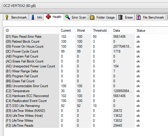

kiddingguy Posted November 20, 2013 Author Share Posted November 20, 2013 These issues might be symptoms that my SSD Vertex 2 is dying on me? The SDD is around 3 years old and in use every day. Can this be a plausible explanation? Link to comment Share on other sites More sharing options...
Eric Veteran Posted November 21, 2013 Veteran Share Posted November 21, 2013 Did you install drivers for your mouse/touchpad after you reinstalled? I know at least the SteelSeries and Logitech HID drivers were causing serious issues. If your SSD is dying you should see SMART errors popping up. HDTune can show your drive's health pretty easily. Link to comment Share on other sites More sharing options...
kiddingguy Posted November 21, 2013 Author Share Posted November 21, 2013 I have a LogitechT620. But with or without software installed give these random freezes, so I guess that doesn't make a difference. Must check on HDTune... Link to comment Share on other sites More sharing options...
kiddingguy Posted November 21, 2013 Author Share Posted November 21, 2013 see screenshot for health status Link to comment Share on other sites More sharing options...

snaphat (Myles Landwehr) Member Posted November 21, 2013 Member Share Posted November 21, 2013 Your SSD is claiming it has 92% of it's usable life left if I'm reading the smart attribute correctly. I didn't bother to read the error rates because the meaning is inconsistent between HDD manufacturers. I would look it up if I were you though. I'm sure you can find something about how it works. Link to comment Share on other sites More sharing options...

Eric Veteran Posted November 21, 2013 Veteran Share Posted November 21, 2013 The HDTune SMART report looks good to me. Have you checked in \windows\minidumps\ to see if there are any fault logs being generated? It might help nail down what's causing it if so. Link to comment Share on other sites More sharing options...
