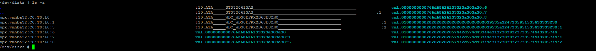

riahc3 Posted April 18, 2014 Author Share Posted April 18, 2014 RAWing the drives does indeed look simple :) Just a couple of questions: I have two drives in my N54L. One is the data store, (ST3320613AS) and another is a drive I just plugged in to see if hot-swapping works (plus I didnt want to shut down pfSense and make everyone lose their WAN connection now) (WD30EFRX). 1: Is there a reason why there is a WD30EFRX WD30EFRX :1 WD30EFRX: 2 entry? I just gonna do with the one without any number 2: When doing: vmkfstools -z /vmfs/devices/disks/<name of RAW device from Step 1> <location to store VMDK>/<RDM name>.vmdk One of the guides uses the serial number (blanked out in the screenshot) to ID the drives. Personally, I think it would be easier to just name them drive1....drive4 since (looking at the box straight on) drive1 is on the left. The reason I dont want to name them by serial number is that if I pop out a drive, I would just have to rerun the commend, with the new "<name of RAW device from Step 1>. Link to comment Share on other sites More sharing options...
+BudMan MVC Posted April 18, 2014 MVC Share Posted April 18, 2014 You can name your rdm whatever you want, I call them mine 1, 2 and 3.. Yes by their positions in the bay, where the 250GB data store is on the far left and would be 0 as to the :1 :2 etc.. Those are the partitions on the disk you wouldn't be using those. Link to comment Share on other sites More sharing options...

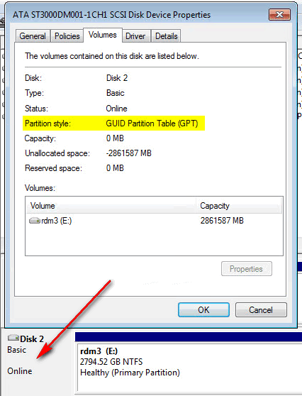

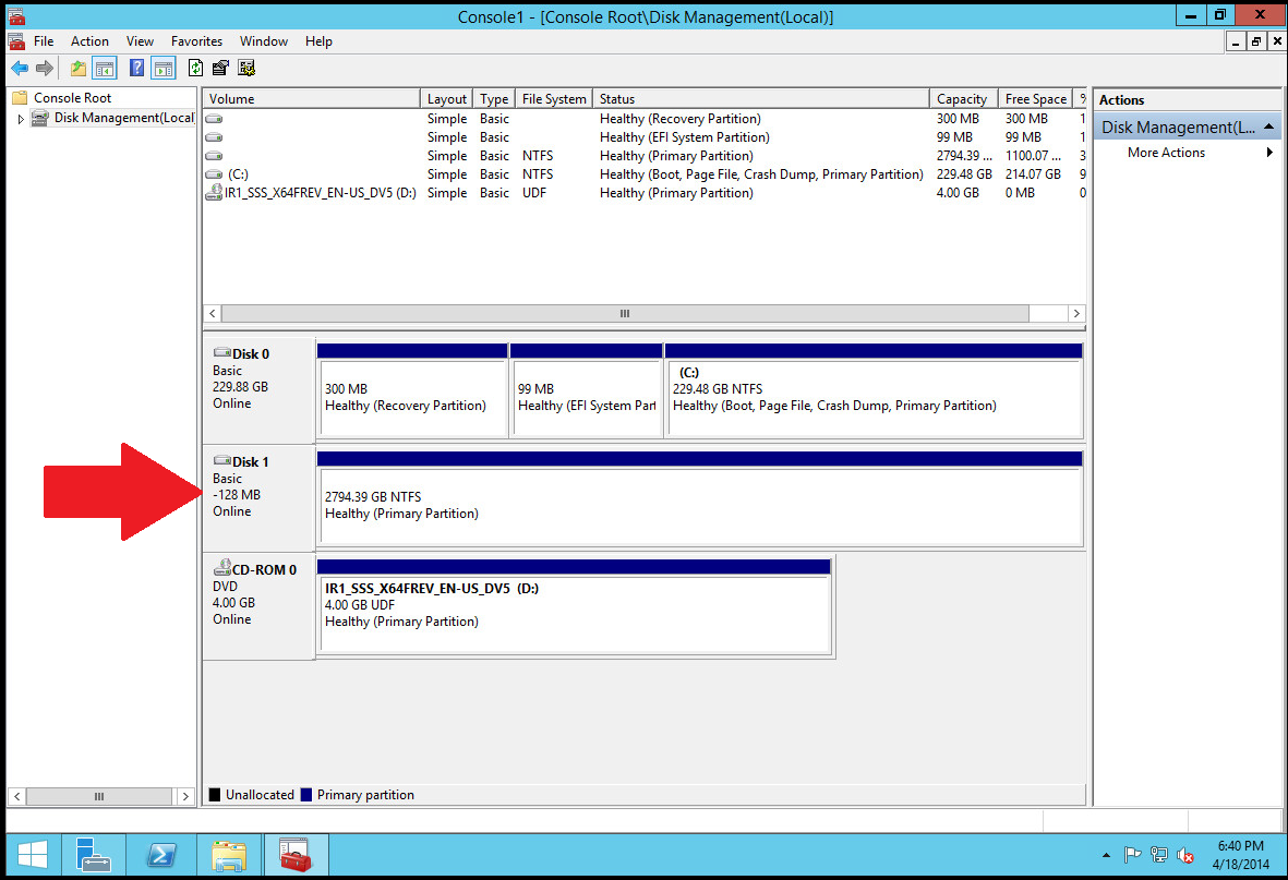

+BudMan MVC Posted April 18, 2014 MVC Share Posted April 18, 2014 As to your -128, yeah 3TB with advanced 4k sectors windows has issues with.. Not a big deal, mine shows 0 ;) You can make sure you wipe all the partitions off of it make it GPT, etc. DrivePool works with it and sees it correctly same with their scanner software. I worked with them when I first installed my 3TB disk because windows has issues. And their scanner was taking what windows was reporting vs getting the info from the disk. Its just a eyecandy sort of problem - the drive works just fine, etc. Link to comment Share on other sites More sharing options...
