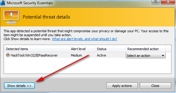

So far, nothing has fixed the Disk Checking error.
I ran a custom scan of MSE, it found the following --
I don't how much they affect Windows.

Well obviously the keygen is used to register whatever program. So you dont have to pay for it.
The Java one. You should keep Java up to date. If you use it. Uninstall all previous versions. And install the latest version of Java ONLY. You can get this (what MSE picked up),  if you visit a malicious / dodgy / hacked site with a vulnerable version of Java.
Since old versions of Java have vulnerabilities. And you can get hacked if you dont remove old versions. Use Javara to remove the rest of the entries, once you've uninstalled old versions of Java
And sulunch!gmb. Not too sure what this can do, but it is a trojan. I would also download / run tdsskiller. See if you've got any rootkits

HackTool:Win32/Keygen
This just means that the Keygen is a Win32 app, not that you have actually installed it on the system.... Yet :)
Really wish AV progs would ###### off and leave my Keygens alone. They know damn well they are no threat to my system.

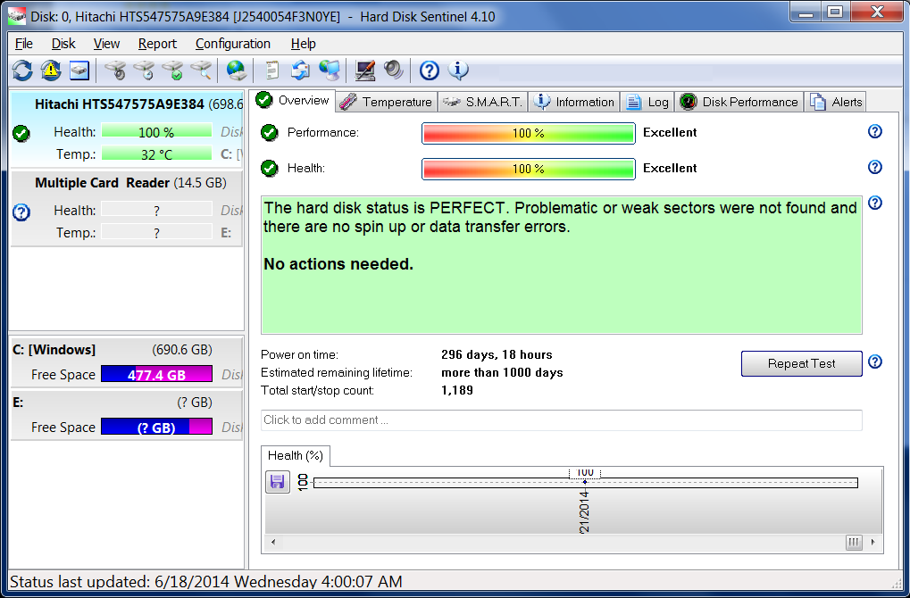

The chkdsk error might be due to the hard drive going bad. Download HDDScan (no install required), select your OS drive, click the round circle -> S.M.A.R.T. Take a snippet of the table and attach it as picture.
Share this post
Link to post
The drive is a little over a year old and the laptop has not been dropped:

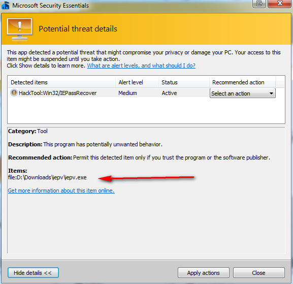

I have not installed any key generators on my laptop -- and certainly not in the Win32 folder.
At a loss for words to be honest ;)  Here I grabbed something I knew would trigger MSE that I is clean useful software
http://www.nirsoft.net/utils/internet_explorer_password.html
Next time you get a warning about something
