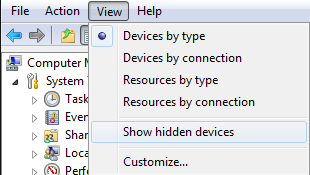

LittleNeutrino Veteran Posted December 1, 2014 Veteran Share Posted December 1, 2014 Have you tried disabling the power control settings on it. I have seen some luck with that. Telling Windows its not allowed to mess with the power on that device? Link to comment Share on other sites More sharing options...
link6155 Posted December 1, 2014 Author Share Posted December 1, 2014 Have you tried disabling the power control settings on it. I have seen some luck with that. Telling Windows its not allowed to mess with the power on that device?how do I do that? I've looked into the driver configurations and I can't find the power management settings. Link to comment Share on other sites More sharing options...
LittleNeutrino Veteran Posted December 1, 2014 Veteran Share Posted December 1, 2014 how do I do that? I've looked into the driver configurations and I can't find the power management settings. Go to the device manager and then double tap or right click and go to properties on the wireless device and then go to Power Settings and Uncheck the box that says " allow Windows to disable this device to save power" Link to comment Share on other sites More sharing options...
link6155 Posted December 1, 2014 Author Share Posted December 1, 2014 Go to the device manager and then double tap or right click and go to properties on the wireless device and then go to Power Settings and Uncheck the box that says " allow Windows to disable this device to save power"There's no settings as far as I can see : Link to comment Share on other sites More sharing options...
enroh Posted December 1, 2014 Share Posted December 1, 2014 There's no settings as far as I can see : this is correct ans the power cfg for the SP3 has been nerfed for battery life. if you do an internet search for power cdfg profiles or something along those lines you will find a reg hack to enable these I believe. Link to comment Share on other sites More sharing options...
LittleNeutrino Veteran Posted December 1, 2014 Veteran Share Posted December 1, 2014 There's no settings as far as I can see : go to tools and show Hidden and then it is listed under Bluetooth (it uses one device for both wifi and bluetooth) Link to comment Share on other sites More sharing options...
link6155 Posted December 1, 2014 Author Share Posted December 1, 2014 go to tools and show Hidden and then it is listed under Bluetooth (it uses one device for both wifi and bluetooth)I don't know where to look for these settings, where do I find "tools"? Link to comment Share on other sites More sharing options...
LittleNeutrino Veteran Posted December 2, 2014 Veteran Share Posted December 2, 2014 I don't know where to look for these settings, where do I find "tools"? Sorry about that, now I feel like a fool. Looks like its View | Show Hidden Items. Link to comment Share on other sites More sharing options...
link6155 Posted December 2, 2014 Author Share Posted December 2, 2014 Sorry about that, now I feel like a fool. Looks like its View | Show Hidden Items. Untitled.png Just tried that and the only device with the "Power Management" tab is the WiFi direct adapter. Also, I think I may have found a solution to the problem. It has to do with what @enroh has said about power management. I followed the following video guide and it has seem to do the trick. I will report back if there's the speed becomes unstable again: http://youtu.be/rTxtXmEGUto enroh 1 Share Link to comment Share on other sites More sharing options...
