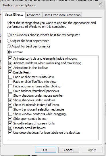

Aergan Posted January 26, 2015 Share Posted January 26, 2015 Yes, it's likely that the Intel HD drivers aren't updated for changes to WDDM. Using driver version 15.33.32.4061 here on my tablet. For the time being I would reccomend dropping some of the visual effects (System > Advanced > Performance) e.g. Fade and translucency. I'm not getting so many issues now. Link to comment Share on other sites More sharing options...
