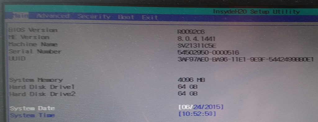

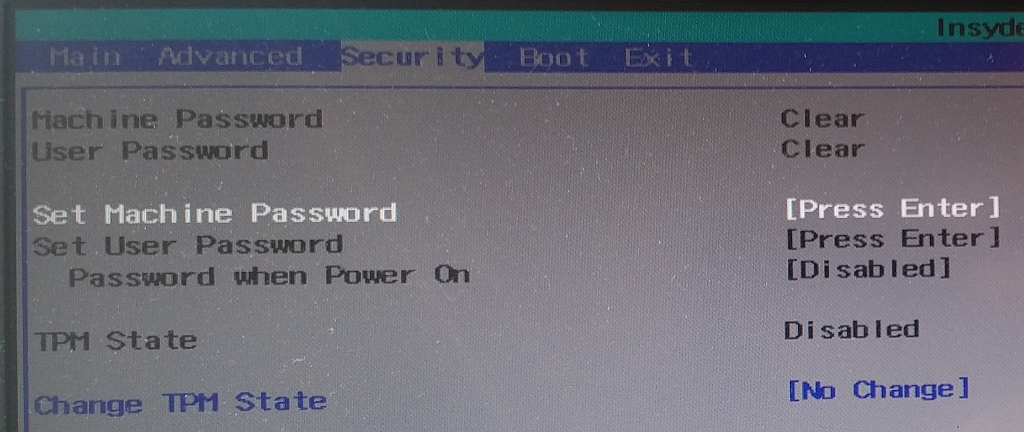

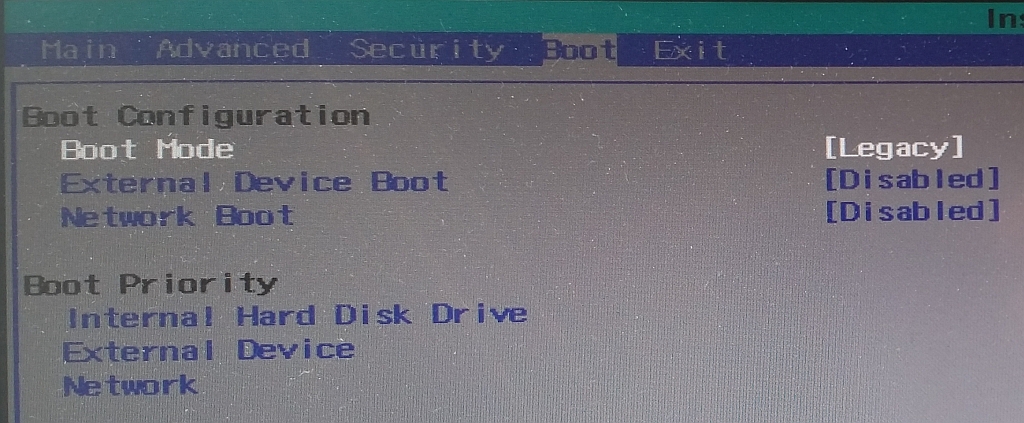

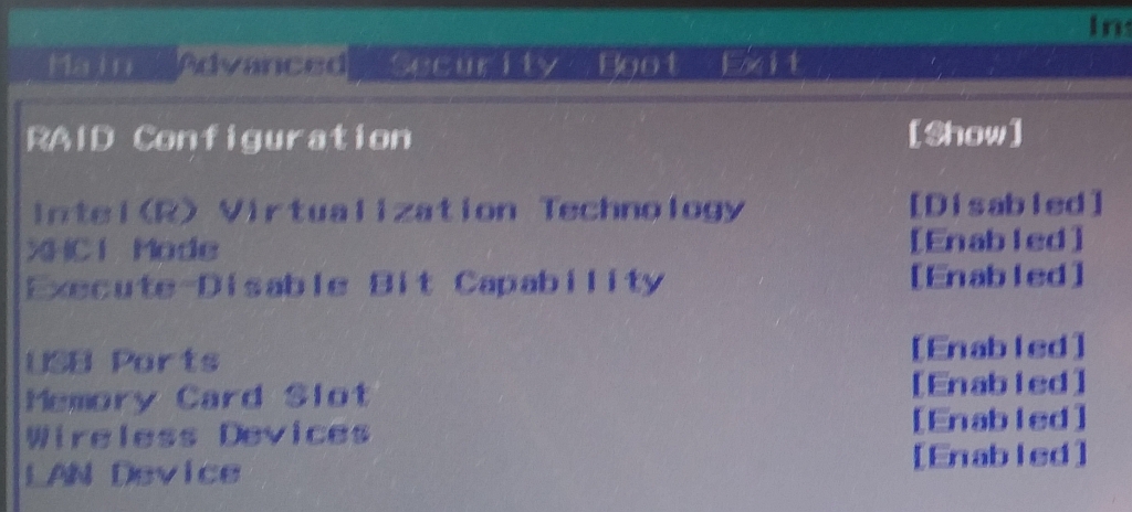

Elliot B. Posted June 24, 2015 Author Share Posted June 24, 2015 Solution # 1: - Go to UEFI and disable Intel IGP and try. - Stick with AMD Display Output Solution # 2: - Try another port like Display Port with output using AMD Display driver and Intel IGP. Solution # 3: - I think when you connect it with Monitor, it uses Intel Integrated Graphic processor, which have known issues with HDMI. You can test these "Test" driver provided by Intel community for feedback purposes: https://communities.intel.com/thread/75262 There is no where in the BIOS to change that setting. (no settings are cropped in the images above) If I change the option on the fourth image to "UEFI", Windows no longer boots ("Operating System not found", or something along those lines) I've tried those test Intel drivers, no change. An old HDMI Cable? Try a new one. The first HDMI Specifications didn't allow resolutions over 1920x1200. The cable need to be at least certified after specification 1.3 and needs to be an "highspeed" hdmi cable. For reference look at the wikipedia article under "version comparsion" and under "cables": http://en.wikipedia.org/wiki/HDMI I'll order a HDMI 2.0 cable from eBay. have you set your monitor to extended mode or external monitor only? Tried all combinations - no change. Link to comment Share on other sites More sharing options...
