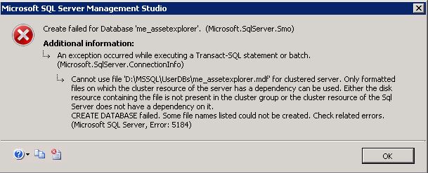

This time around, however, i need to add a new database. In SQL, when i try to add a new db i get an error message:
me_asset.thumb.JPG.0bcf96c8d4ed55e69653f

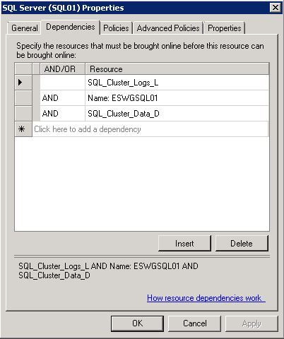

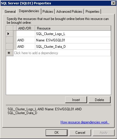

After searching Google I found that the SQL service in FCM needed to have Dependencies set. From FCM, i highlight the SQL service, click Properties, then click the Dependencies tab. I added both our D: and L: drives (data, logs). I then restarted the cluster service. I still get the error.
FCM_dependencies.thumb.JPG.88493510ecac9

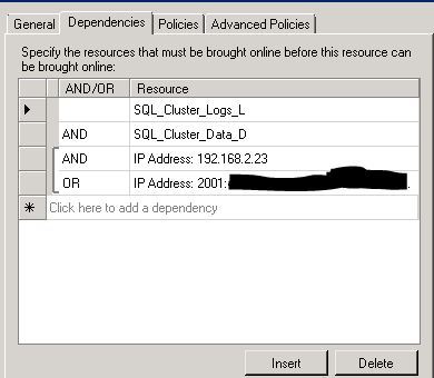

alright! i figured it out!
turns out i was missing a dependency, but i was looking in the wrong spot.
I used this link: http://level7techgroup.com/blog/?p=823
In FCM, select the SQL service under "Services and applications". I was trying to add the drive dependencies under the 'Name' field. This turned out to be incorrect. Instead, i needed to add the D: and L: drives to the Dependencies tab of the SQL Server service under 'Other Resources'.
and.thumb.JPG.00f811841e43cefbd68bc1eb74
What a pain. I sure hope this helps someone else!
