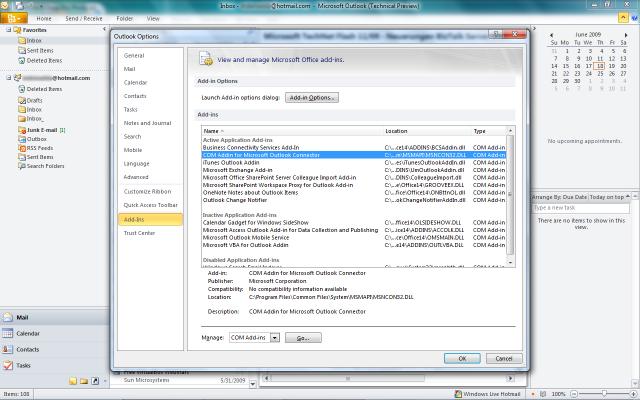

Try again... If the Outlook connector 2007 does not work for you then delete the hotmail account in Outlook 2010 and restart all over.
It will ask you automatically to install Outlook connector when you set up a hotmail account. Just hit yes and the system does the rest.
See screenshot of Outlook Connector plugin in Outlook 2010

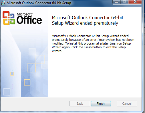

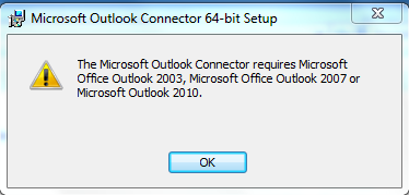

I tried to install the latest version of Outlook Connect but I keep getting the error message that I need to have Office 2003, Office 2007, or Office 2010 installed.
I have Office 2010 installed.
How do I successfully install Outlook Connect for Office 2010?
I saw your screen shot showing that you successfully installed Outlook Connector with Outlook 2010. How did you do this?
Every time I try to install Outlook Connector (12.1 64-bit), I get an error message saying that I need to install Outlook 2003, 2007, or 2010.
But I have Office 2010 64-bit installed.
How were you successfull??
