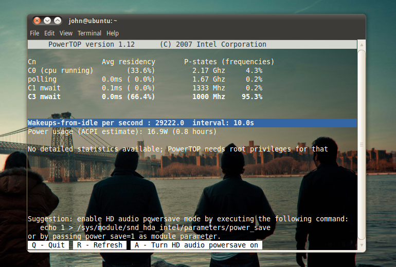

Elv13 Posted May 2, 2010 Share Posted May 2, 2010 I think it's time to run powertop for a small debugging session, then gather some stat out of the raw data in a OpenOffice Calc document to nail down the problem, and submit a bug report. Those kind of bugs are quite high in the priority order these day. Link to comment Share on other sites More sharing options...
KeeperOfThePizza Posted May 2, 2010 Author Share Posted May 2, 2010 I think it's time to run powertop for a small debugging session, then gather some stat out of the raw data in a OpenOffice Calc document to nail down the problem, and submit a bug report. Those kind of bugs are quite high in the priority order these day. Yeah. I'll have to try doing it. I'm not very experienced with Linux yet. This is what I'm seeing so far.. how exactly do i proceed with debugging? Updated, Had to run in Sudo. Link to comment Share on other sites More sharing options...
Rob2687 Posted May 3, 2010 Share Posted May 3, 2010 The Wakeups-from-idle is extremely high in those screenshots. Let powertop sit for a few minutes and do not touch or run anything on your system. It should be much lower. Something in the area of 100 or less when idle. Not in the thousands. Link to comment Share on other sites More sharing options...

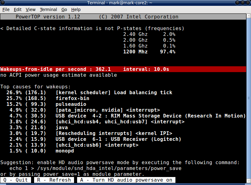

markwolfe Veteran Posted May 3, 2010 Veteran Share Posted May 3, 2010 Just for a comparison, from what Rob was saying, here is a powertop of my PC. I am browsing and playing music from Pandora in the background. Link to comment Share on other sites More sharing options...

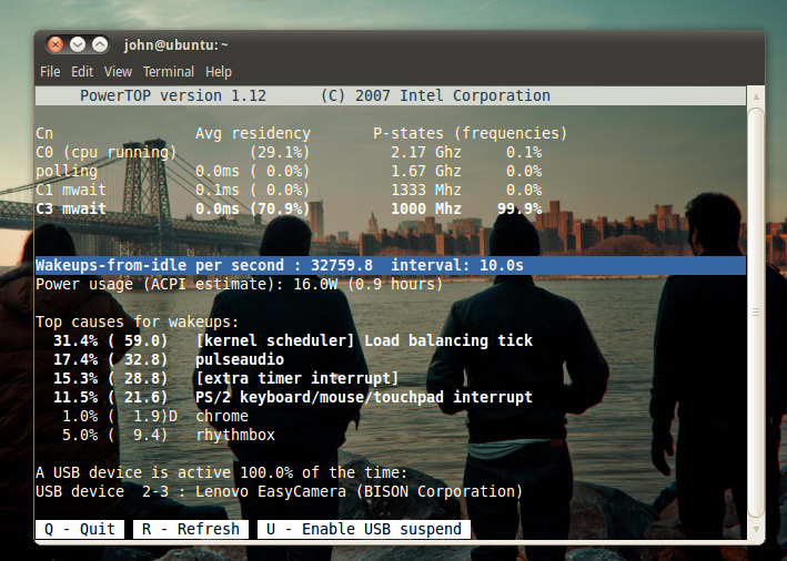

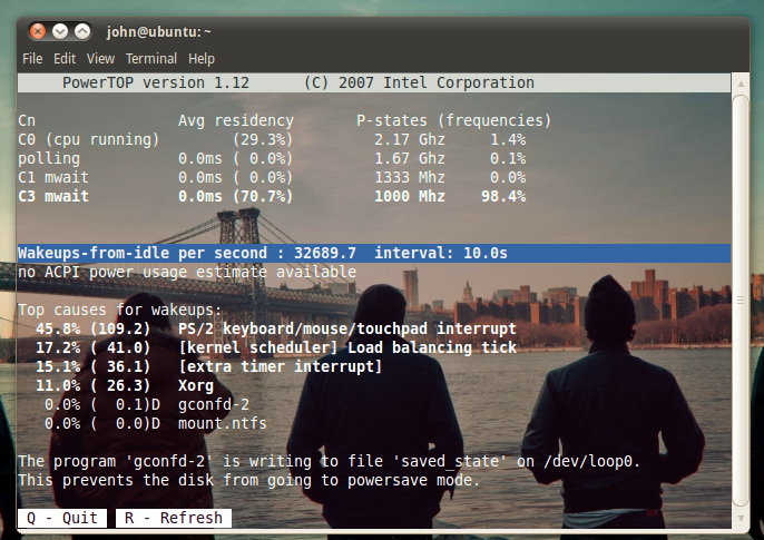

KeeperOfThePizza Posted May 3, 2010 Author Share Posted May 3, 2010 Not sure what's going on. Link to comment Share on other sites More sharing options...
Rob2687 Posted May 3, 2010 Share Posted May 3, 2010 Something doesn't seem right. The 'Top causes for wakeups' shows a list of top activities (both software and hardware) during the sampling period. In the screenshots the 'Wakeups from idle' is very high yet the top causes don't seem to show anything unusual. The CPU stats at the top show that it is dropping to the lowest idle state so I don't see any reason why the CPU would be running hot. You could follow the suggestions that pop up at the bottom which will enable/disable certain things that might help improve power savings. If you're lucky one of the suggestions might happen to be the thing that was causing the problem. e.g. Enabling USB suspend. In your second screenshot it says the USB camera was active 100% time which shouldn't happen unless you were using it at the time. It could be some other hardware that isn't using CPU time but is still active in the background for whatever reason. Link to comment Share on other sites More sharing options...
