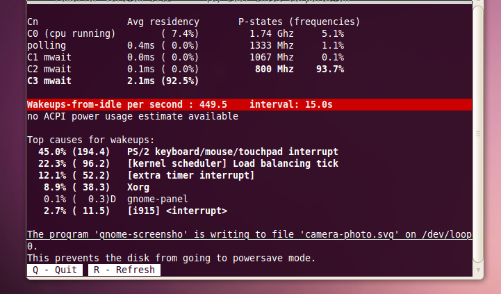

KeeperOfThePizza Posted May 3, 2010 Author Share Posted May 3, 2010 Something doesn't seem right. The 'Top causes for wakeups' shows a list of top activities (both software and hardware) during the sampling period. In the screenshots the 'Wakeups from idle' is very high yet the top causes don't seem to show anything unusual. The CPU stats at the top show that it is dropping to the lowest idle state so I don't see any reason why the CPU would be running hot. You could follow the suggestions that pop up at the bottom which will enable/disable certain things that might help improve power savings. If you're lucky one of the suggestions might happen to be the thing that was causing the problem. e.g. Enabling USB suspend. In your second screenshot it says the USB camera was active 100% time which shouldn't happen unless you were using it at the time. It could be some other hardware that isn't using CPU time but is still active in the background for whatever reason. Well I just reinstalled Ubuntu 10.04, I noticed it says My CPU Supports C1 C2 C3 and that my Bios reports C1 C3.. Would this have any bearing on the high idle count? Also it says " An audio device is active 100.0% of the time: hwC0D0 Intel G45 DEVCTG" Could that be a huge issue why? "Your CPU supports the following C-states : C1 C2 C3 Your BIOS reports the following C-states : C1 C3 " Link to comment Share on other sites More sharing options...
KeeperOfThePizza Posted May 3, 2010 Author Share Posted May 3, 2010 Ok, So i got it down to the hundreds, but it seems to go back up once i start doing things, (Browsing.. Music..) Link to comment Share on other sites More sharing options...
AJerman Posted May 3, 2010 Share Posted May 3, 2010 And it will go back up once you start doing things, that's to be expected. Idling 100-200 is pretty good. See how your temps and battery turn out now. Link to comment Share on other sites More sharing options...
