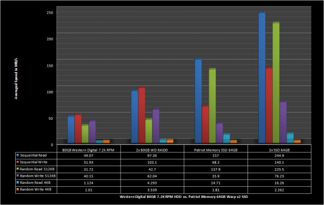

neufuse Veteran Posted October 9, 2008 Veteran Share Posted October 9, 2008 Patriot Memory SSD SATA Warp With the world quickly moving to more efficient devices and higher performance, I felt it was time to try out Solid State Drives (SSD). The world seems to be in a slow transition to Solid State Drives (sometimes known as Solid State Disks; however it?s not actually a disk in the sense we normally perceive a disk). I was looking for a simple, yet effective solution. At this time most drives are still in the $200+ range for a 64GB. I happened to pick up two Patriot Memory SSD Solid State Disks for $179 each, after a $50 rebate on each drive from Newegg.com. The drives are both version 2 drives, which correct some issues that existed in the original Patriot Memory SSD drives. The drives are available in 32/64/and 128 GB models. The drives I purchased where model number PE64GS25SSDR which are listed as SATA I / II drives. The drive is around the standard 2.5? hard drive size. Their dimensions are listed as 3.9? wide by 2.8? deep and only 0.4? high. The drive only weighs about 3 ounces. A nice feature of the SSD drive is it is certified to be used in RAID arrays, some SSD drive manufactures do not suggest you use their drives in a RAID array due to its writing patterns, however, this drive claims it supports RAID0, 1 and 0+1. The drive is RoHS compliant also. One of the real nice features of SSD drives are the fact they are very resistant to external shock, such as dropping a laptop or using it in a car over a bumpy road. The max shock for this drive is listed at 1500G for 0.5ms. The max vibration resistance is 20G at 10 to 2000 Hz. The Mean time before failure (MTBF) is also listed at 1,500,000 hours or about 171 years. ow to format a drive with 512 byte allocation units in vista<[/b]png' alt='b]png'> (This is just one test out of many averaged together) How to format a drive with 512 byte allocation units in vista I know it sounds like a duh, just format it answer. The problem is though, if you run setup for windows vista and click format there, it defaults to 4KB with a 1024 block sector offset. SSD drives are created with a physical 512 byte unit. To get the best performance out of them, you should format the drive to match the allocation unit of the drive. For the patriot SSD drives, it is of course 512 bytes. If you need to create, partition your drive and format it in vista setup, before you go into the actual setup you can go into command prompt and do this manuall. When you are on the Windows Setup screen that has the button to go into the main installation wizard, at the bottom there is a system tools / recovery link, most people never notice this link. If you click it, it takes you to system tools, such as memory diagnostics, and command prompt. Launch command prompt. Use the command DISKPART to create your primary partition. You can do that by running DISKPART, then LIST DISK to get a list of drives in your system, type SELECT DISK #, replace number with the drive you want to create a partition on, then type CREATE PARTITION PRIMARY, this will make the partition the whole size of the drive, or HELP CREATE PARTITION PRIMARY for more options you can use. After this you need to assign a drive letter, after selecting the disk, do a list partition to get the partition number then SELECT PARTITION #, after that type ASSIGN LETTER=C to set it to the C: drive for windows. Now we have a partition manually set up, format it! Exit out of diskpart by typing exit. After this type FORMAT C: /FS:NTFS /V:VolumeLableHere /A:512 this will format the c: drive in NTFS with the specified volume label and the 512byte allocation unit size. Now you can exit out of command prompt, you should reboot the computer, as reboot and shutdown are the two options in recovery mode in Vista setup, then proceed to setup the system like normal, be sure not to format or create new partitions in the setup screen for selecting a hard drive to install to! This will erase your 512byte allocation unit you just setup ower Usage Comparision<disk and click next. This should help improve the speed of the drive and use it to its max potential. Power Usage Comparision I used a small device called a ?Kill-A-Watt? to compare the power usage of the system running in RAID0 mode with two 7200K RPM hard drives versus the same system running with 2 Patriot memory drives in RAID0. To max out the power usage, I did a full disk wipe (DoD standard) for one hour 4 times each setup then figured out the power consumption averaged. The RAID0 7.2K RPM system used ~49 watts more energy in the time then the Patriot Memory SSD drive setup!. The total power consumption of the system running with SSD was 112 Watts, while when running with standard hard drives in RAID it was almost 167 watts. This was with the drives working at max capacity. There is defiantly a power advantage to SSD, as the drives consume as little as one watt of power per drive on max load. The Patriot memory drive however does not havether drive Information<t as already low power. You cannot shut off the drives completely unless a full system power down occurs. Other drive Information Some other things that the drives do not support, Power Management, Acoustic Management (of course), NCQ (Native Command Queuing), they are not firmware upgradable, they do not support HPA?s (Host protected areas) and do not have a write cache. Write cache would be nice because when the drives are under high load, the system does see performance drops. This is something that can be mitigated in standard hard drives with larger write caches onboard. Write caches are usually RAM and much faster than the flash memory or rotational media. In my opinion, SSD makers need to add at least 8MB of roblems Noticed<memory to the device to remove some of the bottle necks that are caused by read and writes while using the system. Problems Noticed As I just mentioned in the other information section, there are problems you notice with SSD drives. One of the largest ones is when you are writing to the drives, it can cause system locks for a second or two if the system simultaneously tries to read. This is something that is mitigated by write caches on rotational media, but on current generation SSD drives there is usually no high speed write cache to save money. I have noticed that when installing applications, the time it takes grew about 35% on average. Windows Vista x64 which took about 30 minutes to go from install to first launch desktop on a rotational media RAID0 setup, now took 43 minutes. However, after the installation things did run faster eat and Sound generated vs. standard drives< is significantly larger then x86 versions of vista which install in about 19 minutes) Heat and Sound generated vs. standard drives These drives seem to generate virtually no heat. My standard rotational media drives generate a good amount of heat during heavy usage; I have noticed almost no increase in heat from the SSD drives. They after 5 hours of usage, feel cool to the touch. Sound wise, it feels odd not hearing your computer doing things. It sometimes feels like the system is stopped because of the lack of noise from the SSD. There is no noise at all from the Patriot Media v2 SSD he big issue with some, defragmentation< who love silent systems. If you want rid of noise, I would highly recommend these drives. The big issue with some, defragmentation People like to tell you ?do not defragment a SSD drive, in fact disable automatic defrag?, I think this is incorrect. Even with the higher access times, having to read random locations on the media still slows down the drive?s performance. I ran tests on a new vista install and saw that a fragmented SSD drive showed similar slowdowns as you would get on a standard hard drive. The decrease in performance of course is not as great as a standard hard drive, but it still slows down. Upon defragmenting the drives, there was a large improvement in performance. One test I did was to backup 39 GB of information using Acronis TrueImage 11 Home edition. The SSD drive fragmented severely took 28 minutes to back up with maximum compression. The same drive defragmented (using Disonclusion<ssional) only took 19 minutes to backup completely. Both backups where done to external media that can write at about 30MB/ps. Conclusion If I was to pick between Standard rotational media and SSD drives from Patriot Media, I?d have a hard choice, the speed is great with SSD, but the lack of write cache causing random slowdowns in the system go get annoying fast. All other factors included I would say the SSD is the way of the future, and hopefully Patriot memory and other SSD creators can improve and fix some of the current issues. I would rate the Patriot Media 64GB SSD v2 an 8.5 out of a possible 10. Link to comment Share on other sites More sharing options...
neufuse Veteran Posted October 9, 2008 Author Veteran Share Posted October 9, 2008 If anyone wonders why I tested two 80GB Hard drives, instead of something newer and larger, I was trying to keep the drives as similar as possible and 80GB was the closest I had to 64GB laying around Link to comment Share on other sites More sharing options...

Skulltrail-old Posted October 9, 2008 Share Posted October 9, 2008 ? Sequential Reading ? 157.0 MB/ps? Sequential Writing ? 68.20 MB/ps ? Random 512KB Reading ? 137.90 MB/ps ? Random 512KB Writing ? 35.90 MB/ps ? Random 4KB Reading - 14.71 MB/ps ? Random 4KB Writing ? 1.81 MB/ps ? Average Access time 0.2 ms (barely one fifth of a millisecond!) ??Forth Test ? Two SSD?s in RAID0t ? Two SSD?s in RAID0 This was the same test as the hard drives in RAID0 test. This test was also run with an Intel MATRIX RAID controller with a 128KB strip in RAID0. The volume was formatted with 512 byte allocation units as per the drive?s storage specifications. ? Sequential Reading ? 244.9 MB/ps ? Sequential Writing ? 140.1 MB/ps ? Random 512KB Reading ? 225.5 MB/ps ? Random 512KB Writing ? 76.23 MB/ps ? Random 4KB Reading - 16.26 MB/ps ? Random 4KB Writing ? 2.262 MB/ps ? Average Access time - 0.2 ms ? Burst Rate 134.7 MB/ps Absolute ownage. I need to get my hands on one of these SSDs ASAP. Surely beats using an 30GB iPod Video (Black/5G) as an external HDD. I would rate the Patriot Media 64GB SSD v2 an 8.5 out of a possible 10. I'd rate it a 9/10. The tests was amazingly good; I rate your experiment a 10/10. Great job. Link to comment Share on other sites More sharing options...

neufuse Veteran Posted October 10, 2008 Author Veteran Share Posted October 10, 2008 Couple pics added, and a screenshot... sorry about the large pic size, very little time... Link to comment Share on other sites More sharing options...
