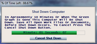

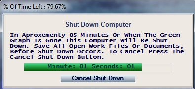

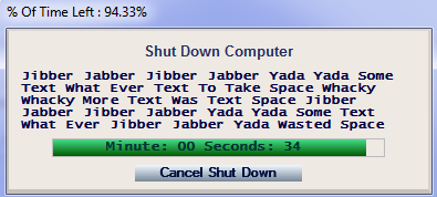

Here is an updated version of the HTA, thank you to those who downloaded this.
Displays The Minutes Ans Seconds Counting Up while the graph shrinks in size.
Made a 5 minute and 10 minute version, graph is scaled to each Counter
Shut Down Gui v2

 <BODY><TABLE>Shut Down Computer</TABLE>
 <TABLE Style='Margin:3pt;'>
  <TD><DIV ID='Txt1' Style='Font-Size:8.25pt;Font-Family:Lucida Console;Font-Weight:Bold;Color:#000047;'>
   In Aproxementy 05 Minutes Or When The Green Graph Is Gone This Computer Will Be Shut Down.
   Save All Open Work Files Or Documents, Before Shut Down Occors. To Cancel Press The Cancel
   Shut Down Button.</DIV></TD>

Shut Down Gui v3
<TITLE>Shut Down Gui</TITLE>
  Coded By Jake1Eye Aka Gunsmokingman 3:32 PM February-11-14

     Border-Bottom:0px Transparent;
     Border-Left:0px Transparent;
     Border-Right:0px Transparent;
   .pgbar
    {width:300pt;
     filter:progid:DXImageTransform.Microsoft.Gradient
     (GradientType=0,StartColorStr='#44DC88',endColorStr='#005a00')
</STYLE>
  <script LANGUAGE='VBScript'>
'-> Varibles Used At Runtime
  Dim C1, C2, C3, Tmr
  Function Window_OnLoad()
   self.Focus
   self.resizeTo 400,187
   self.MoveTo screen.availWidth / 2 - 400/2,screen.availHeight / 2 -187/2
   DemoSelf()
 End Function
'-> Function For The Counter
  Function DemoSelf()
   If C1 Mod 60 Then
    C2 = C2 + 1
   Else
    C3 = C3 + 1
    C2 = 0
   End If
   C1 = C1 + 1
   If C3 = 0 Then C3 = AddZero("0")
   IF C1 = 600 Then
'-> Shut Down Command At 600 Seconds Or 10 Minutes
     CreateObject("Wscript.Shell").Run("Shutdown -s -t 0 -f"),0,True
     window.close()
   End If
   Txt.innerHTML= "Minute: "  & AddZero(C3-1)& " Seconds: "   & AddZero(C2)
   BarSize(int("300") - int(C1/2))
   Tmr = window.setTimeout("DemoSelf", 1000, "VBScript")
  End Function
'-> Resize The Bar
  Function BarSize(N)
   If N > 1 Then document.title = "% Of Time Left : " & FormatPercent(N / 300 ,2)
   bar.style.width = N * 1
  End Function
'-> Add Zero To Display Numbers
  Function AddZero(n)
   If Len(n)=1 Then n="0"&n
   AddZero=n
  End Function
  </SCRIPT>
   In Aproxementy 10 Minutes Or When The Green Graph Is Gone This Computer Will Be Shut Down.
 </TABLE>
 <DIV Align='Left' Style="Width:226pt;Border-width:1;Border-style:solid;Border-color:#BBBBBB;Font-size:9.25pt">
<!-- Position The Text In The Bar Graph Area -->
  <SPAN ID="bar" Class='pgbar'></SPAN>
  <SPAN ID="Txt" Style='Position:Absolute;Top:99;Left:88;Font-Family:Lucida Console;Font-Weight:
  Bold;Color:#003434;Size:7.25pt;'></SPAN>
 </DIV>
<!-- Cancel Shut Down -->
<TABLE Style='Margin-Top:5pt;'>
 <BUTTOn ONClick='window.clearInterval(Tmr): window.close()'>Cancel Shut Down</BUTON>
</TABLE>
</BODY>
ShutdownGuiV3.zipFetching info...
  • 0
  On 13/02/2014 at 17:44, FloatingFatMan said:
Just trying to help pal, don't get your panties in a bunch. :p
Fair enough but
1:\ Thread plus 2400 reads
2:\ 100 or so downloads
3:\ My original post is almost 3 years old
Your the only one who mention the grammar, it a template meant to be changed. I just
as easily could coded it this way.

Code change for DemoSelf() function. You will have to make these changes manually.
10 minute hta
Old
  Function DemoSelf()
   If C1 Mod 60 Then
    C2 = C2 + 1
   Else
    C3 = C3 + 1
    C2 = 0
   End If
   C1 = C1 + 1
   IF C1 = 600 Then
     window.close()
   End If
  End Function
New
  Function DemoSelf()
   C3 = C3 + 1 :C1 = C1 + 1
   If C1 = 60 Then
    C2 = C2 + 1
    C1 = 0
   End If
   If C2 = 0 Then C2 = AddZero("0")
   IF C2 = 10 Then
'-> Shut Down Command At 600 Seconds Or 10 Minutes, C3 = 600
     window.close()
   End If
   Txt.innerHTML= "Minute: "  & AddZero(C2)& " Seconds: "   & AddZero(C1)
   BarSize(int("300") - int(C3/2))
  End Function
5 minute hta
Old
  Function DemoSelf()
   If C1 Mod 60 Then
    C2 = C2 + 1
   Else
    C3 = C3 + 1
    C2 = 0
   End If
   C1 = C1 + 1
   IF C1 = 300 Then
'-> Shut Down Command At 300 Seconds Or 5 Minutes
    CreateObject("Wscript.Shell").Run("Shutdown -s -t 1 -f"),0,True
    window.close()
   End If
    BarSize(int("300") - int(C1))
  End Function
New
  Function DemoSelf()
   If C1 = 60 Then
    C2 = C2 + 1
    C1 = 0
   End If
   IF C2 = 5 Then
'-> Shut Down Command At 300 Seconds Or 5 Minutes C3 = 300
    window.close()
   End If
    BarSize(int("300") - int(C3))
  End Function
