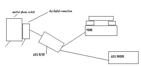

Sleeper Veteran Posted September 19, 2003 Veteran Share Posted September 19, 2003 I have the same problem, it diconnects me then I get the message "No Dial Tone" also there is loads of interferance on the phone line when the ADSL connection is active, the connection just drops when ever it wants, but it happens more frequent when the phone line is in use. I am using the green ADSL modem that Freeserve Supply, im at work at the moment and cant think of its name! Ive attacched a scrible of my setup from the master socket. Link to comment Share on other sites More sharing options...
Inertia Posted September 19, 2003 Share Posted September 19, 2003 your sky digibox is a telephony device that uses the 2-20khz range, It needs to be connected on the telephone side of the filter, in line with your phone, the filter needs to go straight into your socket. BTW I think your modem is an alcatel speedtouch (maybe 330 , or 310, depending on its age) Link to comment Share on other sites More sharing options...

Sleeper Veteran Posted September 19, 2003 Veteran Share Posted September 19, 2003 cheers, i shall change that round when I get home from work Link to comment Share on other sites More sharing options...

Sleeper Veteran Posted September 22, 2003 Veteran Share Posted September 22, 2003 Well, Ive managed to change the way everything is connected into the main phone line, and i have to say fingers cross'd I aint been diconnected yet! so thanks for the advice everyone :D Link to comment Share on other sites More sharing options...
