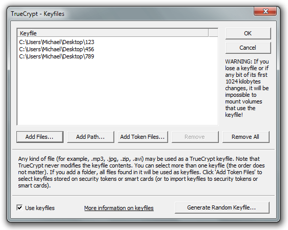

I see. Any file can be used as a keyfile, and Truecrypt volumes can be encrypted using two or more keyfiles. The problem you're having is that Truecrypt is using all of the files in that folder as keyfiles rather than just one. So if you want to add a path, you'll have to put the keyfile in a folder by itself.

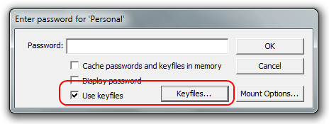

  • 0
  On 16/08/2011 at 06:56, drugo said:
i mean how i create a container with 3 generated keyfiles?
When creating a new volume or changing the password, you have the option to use keyfiles. From this window, simply add two or more keyfiles, and they'll all be used to encrypt the volume.
However, you really don't need more than one keyfile. One keyfile is strong enough that it's virtually unbreakable.
