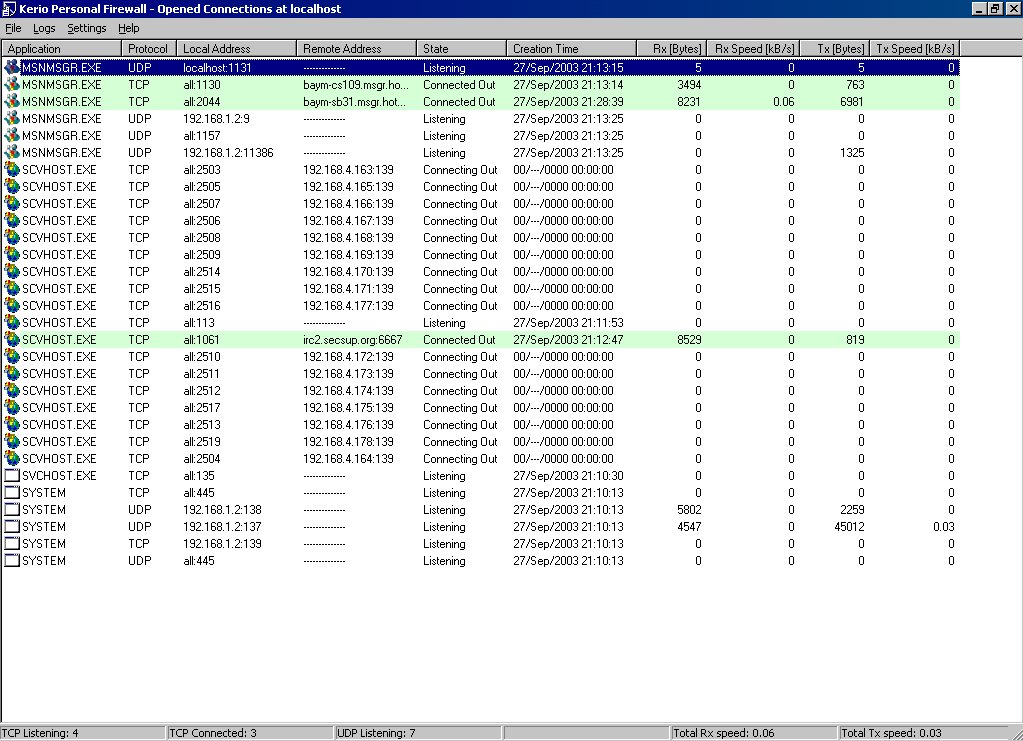

alexp Posted September 27, 2003 Share Posted September 27, 2003 The 1st two highlighted connections are from msn, but the other 1 starts up with windows.. it connects to an IRC server (from EFNet i think??). Nobody in my house will fess up to anything, so it makes my job that lil bit harder. Scanned pc with: NAV 2K Corp; AVG; Adaware; Spybot Search and Destroy; and a few other trojan removers. None of them detect anything. It looks like it's trying to spread itself all over my lan (which is just 1 more pc - not affected). I'm running W2K SP4 (and all further updates from windowsupdate). Any help is appreciated - in the mean time I set up a rule to block it. Link to comment Share on other sites More sharing options...

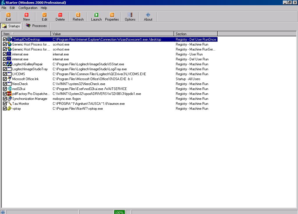

Niels Posted September 27, 2003 Share Posted September 27, 2003 type msconfig in run, then go to the startup tab and see if there is anything in there that shouldn't be. Link to comment Share on other sites More sharing options...
alexp Posted September 27, 2003 Author Share Posted September 27, 2003 no msconfig on my system Link to comment Share on other sites More sharing options...
fpd Posted September 27, 2003 Share Posted September 27, 2003 download codestuff starter to see what your startup processes are Link to comment Share on other sites More sharing options...
null_ Posted September 27, 2003 Share Posted September 27, 2003 Click here to download msconfig for 2000. Link to comment Share on other sites More sharing options...
alexp Posted September 27, 2003 Author Share Posted September 27, 2003 nothing suss there... Link to comment Share on other sites More sharing options...
Mike Posted September 27, 2003 Share Posted September 27, 2003 the 2 scvhost.exe's shouldnt be there (it should be svchost.exe) find where the scvhost.exe is and delete it (after killing it in task manager) Link to comment Share on other sites More sharing options...
Kriz Posted September 27, 2003 Share Posted September 27, 2003 Ye one svhost is quite big aswell Dude, y dnt u just do a full system scan an get it removed? Link to comment Share on other sites More sharing options...
salterbomb Posted September 27, 2003 Share Posted September 27, 2003 i would also check on that internat.exe thing Link to comment Share on other sites More sharing options...
Sn00pY Posted September 27, 2003 Share Posted September 27, 2003 if you got it through MSN it must be the SMB thing... housecall.trendmicro.com do a free ONLINE scan... Link to comment Share on other sites More sharing options...

+Fulcrum Subscriber¹ Posted September 27, 2003 Subscriber¹ Share Posted September 27, 2003 you could actually search for scvhost.exe on Google, and it will turn up results, possibly naming your Definite Virus. I agree with checking out internat.exe as well, definitely some spyware there. Be more careful on downloading through File-sharing networks if you do, because thats the main place these spread, includes IRC. And if you're going to run Kerio Firewall, you should know now that a common way for virus coders to write code victims will not only RUN, but ALLOW their firewall permissions, they use run-off names of popular Windows Processes. Good Luck to you in the future. Link to comment Share on other sites More sharing options...

alexp Posted September 28, 2003 Author Share Posted September 28, 2003 Hi guys, here's a rundown of what's in the startup pic: internet connection wizard internat.exe - because i run multiple keyboard languages the 3 logitech entries are for my webcam also have office startup, then nero, nod antivirus, pdfFactory synch manager is also from windows for infa-red connections taumonitor is an app that i used to kill other apps vptray is nav2k autoprotect funnily enough, as i said before, 3 av suites (norton, avg, nod) didn't detect it. Link to comment Share on other sites More sharing options...
John Veteran Posted September 28, 2003 Veteran Share Posted September 28, 2003 why's the ICW in your startup? :blink: you run that thing once and you're done (depending on your connection, you don't even have to run it once...) Link to comment Share on other sites More sharing options...
alexp Posted September 28, 2003 Author Share Posted September 28, 2003 why's the ICW in your startup? you run that thing once and you're done (depending on your connection, you don't even have to run it once...) i dunno.. it was probably there coz i took the pc offline while it was infected. its not there anymore. im still quite puzzled as to why it wasn't detected by ANY antivirus program. the ones i used were: -nav 2k corp -avg free -nod -http://housecall.trendmicro.com/ -sophos perhaps its a new variant of another virus?? :huh: Link to comment Share on other sites More sharing options...

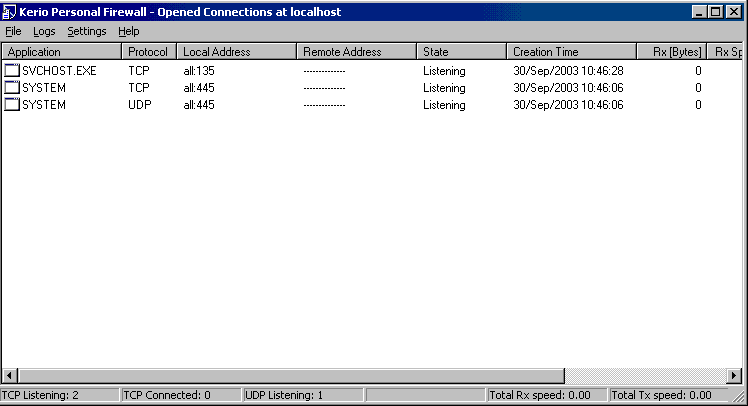

alexp Posted September 30, 2003 Author Share Posted September 30, 2003 hi, i'm pretty sure that it's gone. here's a screenshot of my firewall after startup. Link to comment Share on other sites More sharing options...
