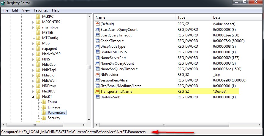

For starters can you post up the full errors your seeing in the event log so we have something to work with.
But off the top what do you show in this key?
post-14624-0-62516100-1321882391_thumb.j
  • 0
I see "\Device\" under TransportBindName aswell Budman.
