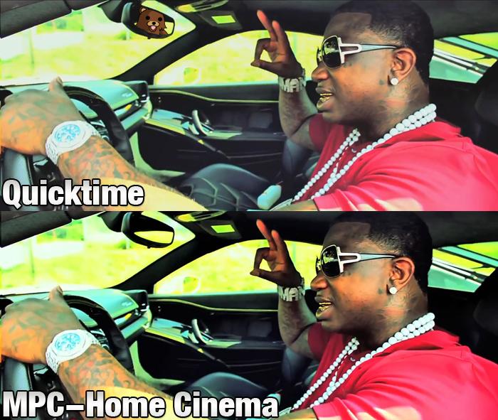

It's kinda like this:
  • 0
Probably has to do with black levels not being 0-255 in Quicktime player for computer viewing. As you use MPC-HC, you can find the setting in the player. In MPC-HC it's View->Renderer Settings->Output Range. If you set it to 16-255 you will probably get the same look as in QT player. As I don't use QT, I don't know if it's possible to adjust this (my guess is not).
  • 0
That's the best explanation I could find on the web. Thanks.
Guess I must live with this "bug".
