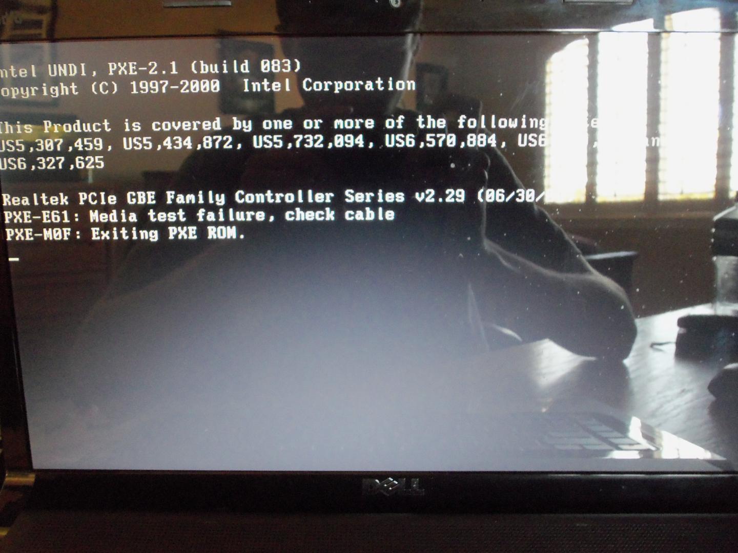

Dell Diagnostic Utility found nothing wrong. I just downloaded and burned Ubuntu 11.10 64-bit to a DVD, but for some reason my laptop won't boot from it. I've used Ubuntu/Linux before and never had this problem before. Here is the message I get:
Realtek PCIe CBE Family Controller Series
PXE-E61: Media test failure; check cable
After this, it reverts back to starting up Windows. I have attached a photo of what the screen looks like. Any ideas?
post-213796-0-14560700-1325615417_thumb.

Make sure that either
A) The CD is the first boot device,
or
B that you just press the boot sectiion key as the bios is posting usually F12, F10, F9 or Escape and then select the Ubuntu Media from that list and press enter.
