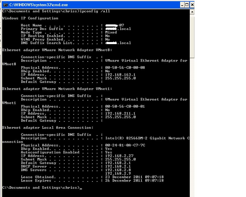

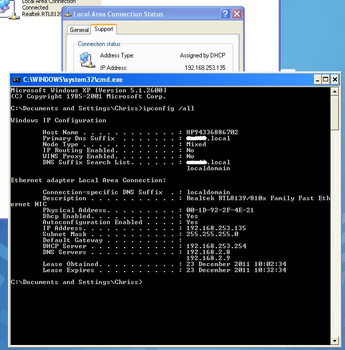

stena Posted December 23, 2011 Author Share Posted December 23, 2011 1st Picture :This is the file showing the incorrect IP details. Our DHCP server is 192.168.2.1 not this. 2nd Picture: This is what a working one looks like (this machine has VMware too so ignore them) Link to comment Share on other sites More sharing options...
TheBlueRaja Posted December 23, 2011 Share Posted December 23, 2011 So find out what 192.168.253.254 is and kick their ass for running a DHCP server on your network.This is the tricky bit, as there is no really easy way to do this. Link to comment Share on other sites More sharing options...
StrikedOut Posted December 23, 2011 Share Posted December 23, 2011 What happens if you run ipconfig /release then ipconfig /renew? Do you know what device the 192.168.253.254 is? It could be an idea to try to navigate to this device in a browser before you do the above to see if it tells you what it is and you should be able to turn off DHCP from there too. Link to comment Share on other sites More sharing options...
