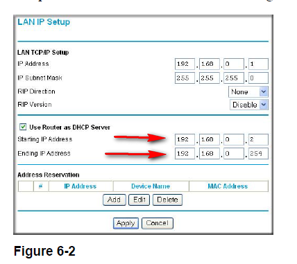

Kai Y Posted December 31, 2011 Share Posted December 31, 2011 Is this something i can change or is it likely to be a fixed setting? It is definitely a setting you can change, if it's a DHCP assignment issue. If the router has 4 wired connections, it can definitely support at least 4 wired devices plus a number of wireless devices... I have never seen a router that accepts only 4 devices on the default settings. According to Netgear's site it "supports up to 253 users". Go into the router's admin page to check the settings. I found the router documentation here... http://kbserver.netgear.com/pdf/dg834pn_ref_manual_11Nov05.pdf look at the picture on page 6-7. The starting and ending IP addresses should be as shown (2 to 254 will mean enough addresses for 253 devices). Also I want to ask if it's only your iPhone having connectivity issues, or is there an issue with the computers as well? If there are also connectivity issues with the computers, it is possible that there are some bugs in the firmware, try to upgrade to the latest firmware and see if the issue persists. Just remember to backup the router settings first before updating. Link to comment Share on other sites More sharing options...

Technique Posted December 31, 2011 Author Share Posted December 31, 2011 I had a look & my settings look EXACTLY like that Except for the "Rip version". "Disable" isn't an option. Mine says "RIP1". All other machines (certainly the wired ones) seem to be fine. I know the PC i'm typing right now is fine. My gf's Galaxy Tab is fine. My sisters iPhone seems fine. My iPhone doesn't want to play. As for firmware version, i have the latest. Link to comment Share on other sites More sharing options...

+BudMan MVC Posted December 31, 2011 MVC Share Posted December 31, 2011 "Can this router ONLY accept 4 total connections" No this would not be the case, unless you set your dhcp server on your router to only have 4 IPs it can hand out. But then that would only mean it could only hand out 4 leases at a time, static IPs would still be able to work, etc. You sure your broadcasting your SSID? Make sure you are and its UNIQUE. Where you could have issues if say your SSID is netgear and there are other netgear SSIDs in the area - your device could try connecting to those if signal is stronger, etc. You should set a UNIQUE ssid, you should be broadcasting it - and then you should also be using WPA or WPA2 with strong PSK. How many dhcp leases are you set to, a common default is from like 100 to 150 -- so 50 devices could have leases from your dhcp server. How many ips do you show available? But you should be able to handle many more than 4 devices -- now keep in mind wireless is shared!! So if one of them is using up all the wireless bandwidth, then other devices could be having issues. Not in holding the connection, but things might be really slow, etc. You really need to verify what wireless network your connected to, the device should show the MAC address of the AP its connected to somewhere in its wireless status, and then verify this is your wireless routers radio mac, etc. Link to comment Share on other sites More sharing options...
Technique Posted December 31, 2011 Author Share Posted December 31, 2011 Positive about the SSID. Every device was set up to auto-connect anyway. It's only my sisters iPhone that's been different which she just got today. We also live in the wilderness - so no interference from other networks at all. Although the SSID is unique regardless & we're using WPA2-PSK. How many dhcp leases are you set to, a common default is from like 100 to 150 -- so 50 devices could have leases from your dhcp server. How many ips do you show available? I wont even pretend that i know what you're talking about, so i went into my router settings looking for anything that said "DHCP" "Use router as DHCP server" - this box was ticked & this exact page is what Kai linked to in the above post. This was the only mention of DHCP that i found. The connection wasn't just slow, it was non existant. As said earlier, can i do anything within this to enable device 1, 2, 3 priority connection over 4, 5, 6? And to take it further, can i enable devices 1, 2, 3 to have priority bandwidth over devices 4, 5, 6? Link to comment Share on other sites More sharing options...

+BudMan MVC Posted December 31, 2011 MVC Share Posted December 31, 2011 "Use router as DHCP server" - this box was ticked & this exact page is what Kai linked to in the above post. So you saw this? So that is handing out IPs between 2 and 254 so what 252 possible connections. That is what yours showed? Then its not dhcp issue -- how do you know its not your phones problem? Link to comment Share on other sites More sharing options...
Technique Posted December 31, 2011 Author Share Posted December 31, 2011 So you saw this? So that is handing out IPs between 2 and 254 so what 252 possible connections. That is what yours showed? Indeed it isThen its not dhcp issue -- how do you know its not your phones problem? I don't, i was just guessing, as my phone has been able to connect to my home network without issue for over a year now. My sister gets her iPhone today, connects to the home network & boom, my phone begins having issues, so i GUESSED that it was to do with her iPhone/the connection allowance. Link to comment Share on other sites More sharing options...
