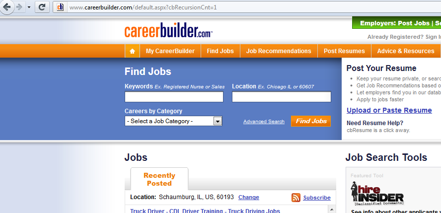

post-14624-0-28667900-1325518111_thumb.p
Flush your dns cache and try again -- you should get a different IP this time
