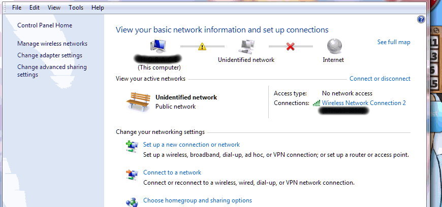

leesmithg Posted January 4, 2012 Share Posted January 4, 2012 Hello. Problem my daughters PC acquired yesterday. I tried this and that and thought that manually adding ip address, gateway subnet etc might help. Wrong, well I could update the antivirus, but no browse the net. Where is say 'Unidentified Network', that changed to Home Network. However it seems no connection to router then to the net. The notification icon for network connection is on full, connected and has an exclamation mark. So any ideas on how to get the network back to full working order, as a home network and able to browse the net? Thanks in advance Lee Link to comment Share on other sites More sharing options...

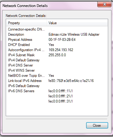

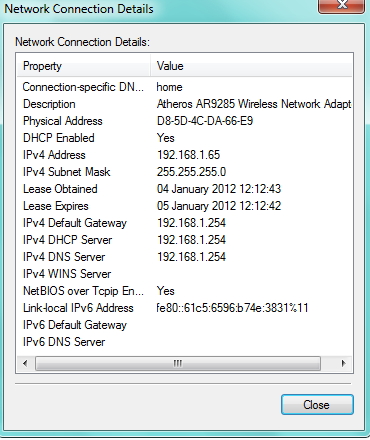

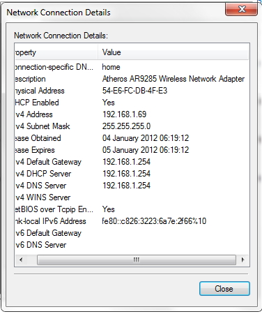

leesmithg Posted January 4, 2012 Author Share Posted January 4, 2012 Hello Max, no version 3. edit/I sorted out DHCP erros also. Here is where the problem lies, IPv4 assigns a wrong address. Mine: Daughters: Sons: Thanks for replies. Link to comment Share on other sites More sharing options...
Daedroth Posted January 4, 2012 Share Posted January 4, 2012 First, I would disable IPv6 on all your computers, as it's pointless for you, and can cause an unnecessary problem. The fact that your daughter's computer is getting a 169. IP address means it doesn't know where to get it's IP from. I see you are connecting via wireless. Try deleting all wireless profiles, and try again. Use Windows' wireless features, rather than 3rd party applications. Ensure you're connecting to the correct wireless signal. Link to comment Share on other sites More sharing options...

+BudMan MVC Posted January 4, 2012 MVC Share Posted January 4, 2012 169.254 means that a dhcp client did not get any answers from dhcp server. For starters I would connect with a wire vs wireless when troubleshooting if its s dhcp issue or not -- you said your dhcp service was not starting? So connect it with a wire to your router - do you get a 192.168 address then, and does network work, etc. If not then you got dhcp issue, still on wire assign a static IPv4 address -- does it work then? If not then you got something really wrong with the stack. If all works with wire just fine, dhcp, etc. Then its a wireless issue and not dhcp, etc. Link to comment Share on other sites More sharing options...

RATiO Posted January 4, 2012 Share Posted January 4, 2012 I had this problem recently. Kept getting an apipa address (169.254.x.x). It happened after switching the USB port I was using the adapter on. Are you plugging it into some kind of USB hub? If so try plugging it directly into PC. If your daughter has changed the port she plugged it into try putting it back where it was. I have found after years of using wireless adapters that Windows installs a whole new driver everytime you change usb port and you endup with things like Wireless connection #2, Wireless connection #3 etc Also, is it possible there is malware on the machine? And make sure all neccesary wireless networking services are running especially DHCP client. I don't have a list to hand but look around on net you will find. Finally, try setting a manual IP address (I take it you know how?) 192.168.1.xx with a gateway of 192.168.1.254, a dns of 192.168.1.254 and subnet 255.255.255.0. Oh and if theres anything resembling 'Microsoft Virtual Wi-Fi Miniport Adapter' in Wireless connections, disable it. Link to comment Share on other sites More sharing options...

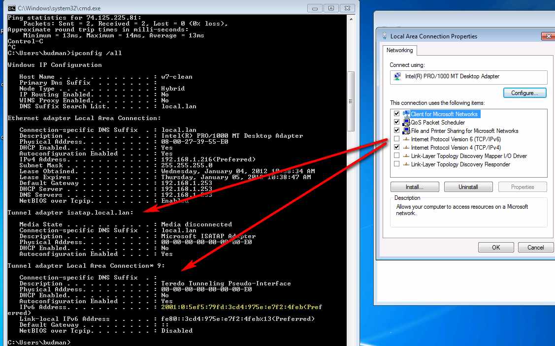

+BudMan MVC Posted January 4, 2012 MVC Share Posted January 4, 2012 "Windows 7 and Server 2008 use IPv6 for background communications" NO THEY DON'T -- don't go spouting nonsense. Now if your using homegroups, then yes ipv6 is used in that. I have to agree if your NOT using a protocol, then that protocol should not be running.. If you not actively using ipv6, then there is no reason for it to be enabled. And it is quite simple to disable from elevated cmd prompt reg add hklm\system\currentcontrolset\services\tcpip6\parameters /v DisabledComponents /t REG_DWORD /d 255 Reboot If you want it back simple as removal of the regkey reg delete hklm\system\currentcontrolset\services\tcpip6\parameters\ /v DisabledComponents /f Now if you WANT to play with IPv6 -- then more power you, but do it RIGHT, don't just leave the nonsense that MS leaves running run because you don't understand it. I run it on a few machines on my network because yes some day it will be main stream -- personally I think it 5 to 10 years out yet for sure. But if going to play with it -- then go get yourself a FREE tunnel if your ISP does not support it yet (most likely) you can get one at hurricane electric. Also I would go through their course and get certified.. When you reach Sage level you get a Free t-shirt. Takes all of about an hour to get to that level if you have an understanding of IPv6 and networking in general. You have to bring up a few services on ipv6, etc. http://ipv6.he.net/certification/ But again NO win7 and Server 2008 have no NEED of ipv6 to talk in the background -- in the background to who btw??? For starters disabling ipv6 will make your ipconfig /all easier to read.. And if you setup ipv6 correctly its not as cluttered as having teredo and every other thing MS turns on by default.. Its not the way I would of done it for sure -- everything security says to disable until required, sorry but ipv6 is not required so have it it installed but not enabled. Users that need it can quite easy enable the aspects of it they need. I am using IPv6 on this box C:\>ipconfig /all Windows IP Configuration Host Name . . . . . . . . . . . . : i5-w7 Primary Dns Suffix . . . . . . . : local.lan Node Type . . . . . . . . . . . . : Hybrid IP Routing Enabled. . . . . . . . : No WINS Proxy Enabled. . . . . . . . : No DNS Suffix Search List. . . . . . : local.lan Ethernet adapter Local Area Connection: Connection-specific DNS Suffix . : Description . . . . . . . . . . . : Broadcom NetLink (TM) Gigabit Ethernet Physical Address. . . . . . . . . : 18-03-73-B1-0D-D3 DHCP Enabled. . . . . . . . . . . : No Autoconfiguration Enabled . . . . : Yes IPv6 Address. . . . . . . . . . . : 2001:470:xxxx:b85::666(Preferred) Link-local IPv6 Address . . . . . : fe80::e0cd:efb8:f50:7e7b%13(Preferred) IPv4 Address. . . . . . . . . . . : 192.168.1.100(Preferred) Subnet Mask . . . . . . . . . . . : 255.255.255.0 Default Gateway . . . . . . . . . : 2001:470:xxxx:b85::1 192.168.1.253 DNS Servers . . . . . . . . . . . : 192.168.1.253 NetBIOS over Tcpip. . . . . . . . : Enabled C:\>ping ipv6.google.com Pinging ipv6.l.google.com [2607:f8b0:4001:c01::67] with 32 bytes of data: Reply from 2607:f8b0:4001:c01::67: time=44ms Reply from 2607:f8b0:4001:c01::67: time=44ms Yes I sniped out part of my global ipv6 address -- because yeah you can get to that from internet, not like private IP. Link locals are just that local links - so no reason to hide those. But again I agree if NOT actively using ipv6, then reason to have it running -- disable it, but that is not going to fix his issue at all. At best make reading ipconfig a bit easier. edit: "IPv6 will only be needed on outward facing connections" You really don't grasp the concept of using IPv6 do you.. When all said and done all devices will have IPv6 address and ipv4 will be gone. There will be not reason for nat, etc. All devices in fact will have multiple ipv6 addresses, both local link and global, etc.. DNS is your Friend with working with devices that are on ipv6 ;) Because even with shortcuts the addresses can be a bit long ;) When you get your FREE tunnel from HE, you get a /64 -- every strand of carpet in your house could have its own unique IP and it would not even dent your available space with a /64 -- and if you want you can get a /48 so you can route multiple /64s ;) Link to comment Share on other sites More sharing options...

Daedroth Posted January 4, 2012 Share Posted January 4, 2012 I have to agree if your NOT using a protocol, then that protocol should not be running.. If you not actively using ipv6, then there is no reason for it to be enabled. And it is quite simple to disablefrom elevated cmd prompt reg add hklm\system\currentcontrolset\services\tcpip6\parameters /v DisabledComponents /t REG_DWORD /d 255 Reboot There is an easier way, for the less technically advanced. Go into your network connections, right click your adapter and go into Properties. Remove the tick from IPv6. Apply > OK. Reboot. Link to comment Share on other sites More sharing options...

+BudMan MVC Posted January 4, 2012 MVC Share Posted January 4, 2012 "Remove the tick from IPv6. Apply > OK. Reboot." That does not remove the output from ipconfig /all though ;) see How much technical skill does it require to open an elevated cmd prompt and paste in a command? ;) "I have tried everything else mentioned here also." So you connected this box to your router with a WIRE?? Link to comment Share on other sites More sharing options...
