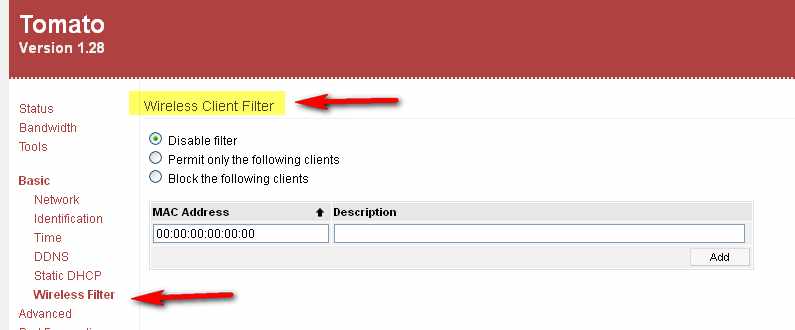

+BudMan MVC Posted January 4, 2012 MVC Share Posted January 4, 2012 Well MAC filtering effectively stops unwanted users from accessing a network Says who -- what router are you using that setting a mac filter blocks anything to do with "WIRED" accessWe are talking wired access here, ie PLA not a wireless client trying to connect to your AP and then passing traffic to other devices or use the internet. Also lets say the router blocks access on the wired interfaces with mac filtering -- lets just say it does, but I can not recall ever seeing a soho router that provides that feature in any method that would be actually useful. Does he have another switch on the network? Even if mac filtering blocked access to the wired ports on the router, that does not stop any traffic between interfaces on the switch downstream where devices are connected. Here for example is tomato. Notice for one that it is not even in any sort of SECURITY MENU, and clearly stated as a "wireless" client filter.. And as already stated simple sniffing of the wireless traffic can get you valid macs to use, even if the wireless is encrypted - the macs are not. So here is example that does support WIRED mac filtering -- but really want to point this part out about still having access to wired devices. --- Grabbed this from help of dlink 655 emulator http://support.dlink.com/emulators/dir655/133NA/Advanced.html#MAC_Address_Filter Filter wired clients: Apply MAC Filtering to devices that are physically connected to the network (as by Ethernet cable). Note that a wired device that is blocked cannot access the WAN and cannot access wireless devices on the LAN, but can still access other wired devices on the LAN. --- So even with this router and no other switches that does support blocking via mac on its wired ports, it does not prevent access to the network. It only blocks access to the internet, and then wireless clients.. Guess that would be fine if he didn't have any wired devices.. But he is connecting his PLA to connect something to to his network via a wire, so there are clearly other wired devices on the network that mac filtering would not block. Also keep in mind that it makes no mention of blocking access to the routers admin page - so could in theory hack the routers admin page and then turn off mac filtering. Mac filtering is great as a method of controlling say your kinds from using the internet after 10pm, or easy way to turn off access to internet for your kids if they are grounded or something. But as way of actually securing your network, ie security no -- not by a long shot, not at least in any form I have seen on soho routers. Now in a fully managed or even smart switch setup, sure mac addresses can be used as NAC (network access control) Where you for say only allow specific macs to use a specific wired port, or prevention of unwanted devices from just plugging into your network.. But then again in that sort of setup any ports not being used should be OFF anyway. But sure works great as a "control" method of keeping users from willy nilly moving to different ports. And in such a setup you might even want to use NAP (network access protection) where you require the client to meet specific criteria before they can access specific aspects of the network. But again, since you can change the mac of your interface in 2 shakes, and there is no real way to "secure" the macs of devices that are actually using the network -- its not a real "security" method. Like saying passwords are secure, if the passwords were posted on your computer with a postit and sent over the network in clear text at all times. Does not matter if the passwords were 100 characters long -- how secure would that be? Which is exactly what happens with mac addresses, they are transmitted in the clear both wireless and wired, and they are quite often printed right on the device. Simple IPconfig or ifconfig on linux will show you mac of that devices interface, do a simple arp -a and you can view every mac that device has been talking to on the network. Most every other device that does not have a real OS more than likely has the mac printed right on it - turn your router over and you should see both the mac for its wired interfaces and its wireless radio. MAC Filtering is not a valid security method - control sure it has lots of uses, as valid security NO not in any sense of the word. djdanster 1 Share Link to comment Share on other sites More sharing options...
