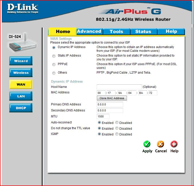

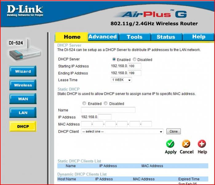

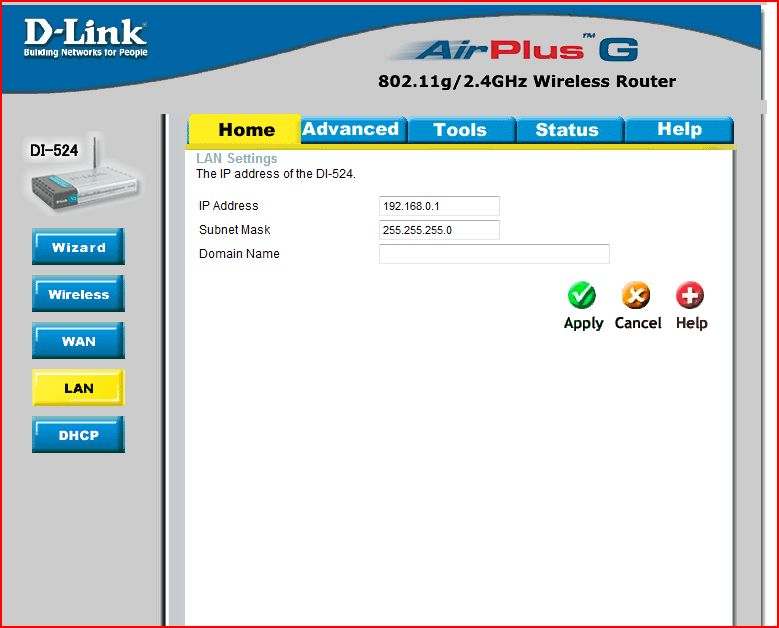

Delightus14 Posted January 30, 2012 Author Share Posted January 30, 2012 Ok. I understand what you want me to do. Just dont know which settings on the router to change. Obviously you guys might have a different router to me, but hopefully you can deduce from these screenshots. From 1.jpg - Do I select option 2; Static IP? If So refer to 1a.jpg. - Do I change anything else from the selection? Leave blank? Or put new DNS/Gateway addresses? Now both of those options were from the WAN page. Do I change on this page or from the LAN page? Refer to 2.jpg. - As this is on the LAN page, do I just change the IP address to say what Lars77 said for example 192.168.1.2 ? Also included screen shot of the DHCP menu - refer to 3.jpg. - As from above responses, I disable DHCP server? - Do I change it to a Static DHCP? And change the IP address to what I wrote above? Would really appreciate some more help guys. So far you have helped alot but just need some tailoring. Thank you alot Link to comment Share on other sites More sharing options...
+BudMan MVC Posted January 30, 2012 MVC Share Posted January 30, 2012 Your not going to be using your WAN port so 1 and 1a are kind of pointless to what you do with them. Not going to matter at all what is set in there - again your NOT using the 2nd routers wan port. Yeah you would change the IP to something on your first routers network.. So if your first router is 192.168.1.1, then sure 192.168.1.2 would work. Just make sure nothing else on your network is using that IP, nor is it in the range of ips your first router could hand out in dhcp. image 3 not sure what you do not grasp about Disable DHCP server -- that seems pretty clear to me.. See the DISABLE radio button. That static section on the bottom of that page is for reservations of IPs this dhcp server would hand out - but since its going to be disabled - then that sections is again a non topic issue. Link to comment Share on other sites More sharing options...
