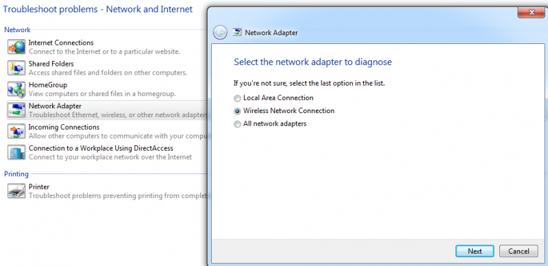

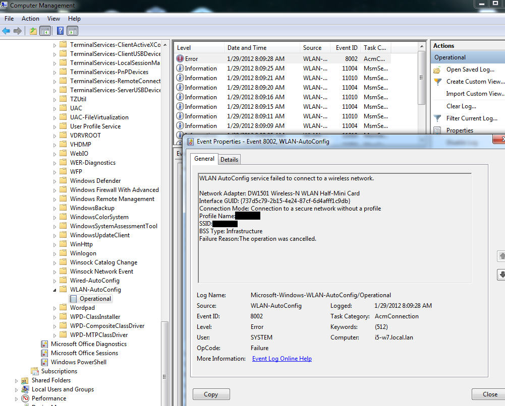

+BudMan MVC Posted January 29, 2012 MVC Share Posted January 29, 2012 And have you looked at the logs? Have you tried the diagnostics? Without some actual info to go on your never going to fix it. Link to comment Share on other sites More sharing options...

+BudMan MVC Posted January 29, 2012 MVC Share Posted January 29, 2012 Lets just all make random guesses to why something does not work -- I mean why should we even bother to look at the information the OS will give us to why something doesn't work when we can just randomly guess to what the problem is ;) I guess its because Mars is retrograde currently.. helpifIcan 1 Share Link to comment Share on other sites More sharing options...
