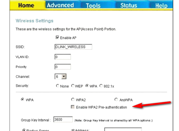

+BudMan MVC Posted January 29, 2012 MVC Share Posted January 29, 2012 Yes I agree that wpa2 allows for PMK and PMK caching and Pre-auth lots of GREAT things!.. You do understand that those are used normally used with 802.1X -- Not something normally used in the home setup As to what your devices support -- nor sure without reading the specifications of the hardware and or drivers of that hardware your using. My point is just because your using WPA2, which by default is AES btw.. Does not mean your going to be using pre-auth and PMK caching, etc. etc.. This comes down to the hardware/drivers and AP in use and what their makers has decided to use out of the available standards. "All WPA2-enabled devices support PMK and pre-authentication while roaming" You can not make such a blanket statement!! Here quick google Clearly this router DSL-2640T, does not have allow for pre-auth unless the user says so -- which is MY POINT! Thats nice that when your using WPA2 aes with your client and your AP that you do not notice any issues when switching between AP.. Does not mean that is an across the board feature off all devices using wpa2 aes. Nor does it mean that users would have any sort of issues if using WPA and multiple accesspoints on their home network.. Wireless networks drop packets all the time! Moving from one AP to another is normally only going to be at most a say 100ms even without PMK caching, pre-auth, etc. etc. Most home users are not going to have any issues.. And again I am 100% behind using WPA2 in AES mode only -- but that does not out of box include 802.1r and k specifications for fast roaming, etc. Nor is using WPA or WPA2 tkip+aes modes going to be much of a problem with users using multiple AP in their home. These standard are designed more for the enterprise setup where you have a large number of AP, and lots of users and they are on the move -- especially with mobile phones!! Which when using 802.1x the authentication process can take some time.. For all you know the radius server is other side of the planet for the enterprise - so yeah voip could have some real issues when moving across AP. These standards and changes are great -- but I think you read some stuff and are trying to apply these technologies and feature sets of high end enterprise wlan controllers and AP to the home market.. Which is just not the case. Link to comment Share on other sites More sharing options...
