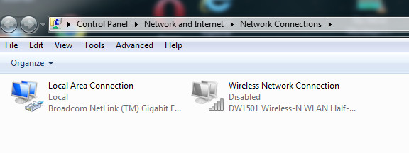

+BudMan MVC Posted February 5, 2012 MVC Share Posted February 5, 2012 "I have enabled the network card" You should have multiple network cards - one being wired, and the other wireless -- example Do you see the actual wireless card?? Link to comment Share on other sites More sharing options...
