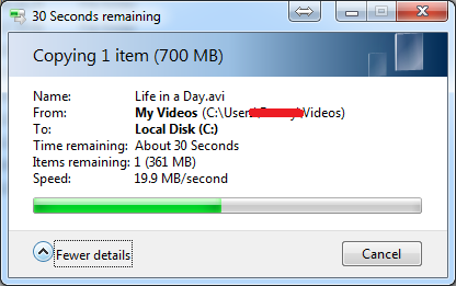

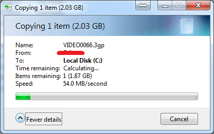

I just tested your theory. As was expected, the bigger file (in this case a homemade porno :p) copies much faster than the smaller file (Indie YouTube movie):
k,
i did the same thing and had the same results, bigger file faster, jsut no porn.
but i still stand by my answer of the N vs G adapter not beign the cause, if choose to think otherwise so be it.
then were both wrong, i did the same thing and had the same results, bigger file faster, jsut no porn.
Huh? I've said since the beginning that a bigger file will copy faster than a smaller one, hence "calling B.S." :s

Bigger file copies faster?? Where do you people come up with this? For one you did not even let those copies finish, second I would not put much faith into that dialog and actual speed, etc. If you want to know the speed of a file copy you need to let it complete and time the transfer. Robocopy is a good tool for this since it reports this after the copy

Looks like bigger file was slower to me!
There are a lot of variables here.. You could have a 100MB file that is fragmented to all hell on the disk, and you could have a 1GB file nice and sequential.. Or it could be the other way around.
You can not make blanket statements like large copy faster, than smaller. Now are you meaning that 1 large file copies faster than lots of little files that add up to the same amount of data? Then sure the 100MB file will normally copy faster than 100 1MB files. There are many variables involved in moving a file.
