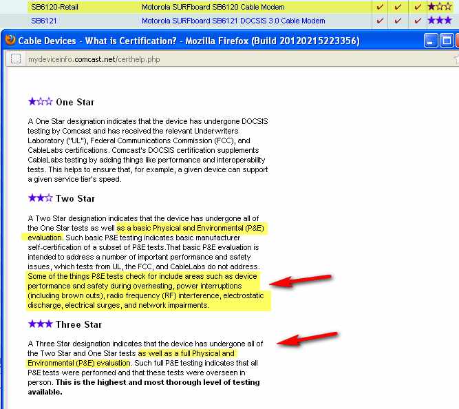

+BudMan MVC Posted February 20, 2012 MVC Share Posted February 20, 2012 What router do you have -- some can give different dns info vs just pointing to themselves -- others can not. Can your router run 3rd party, then for sure you would have the option. dd-wrt, tomato are examples of 3rd party router firmware. edit: "I found out that my SB6120 modem did not meet all of Comcast's tests. So to fix this I bought a SB6121 modem that meets all of comcast's tests.My old modem (SB6120) would lock up every time someone on the network would use a P2P application." I have a SB6120 -- and it has no problems running p2p! As to not meeting comcast tests, those are just PE tests.. Have nothing to do with the modem working correctly on that network. Unless the modem is stored in an oven or icebox those certs don't mean much ;) Link to comment Share on other sites More sharing options...

+BudMan MVC Posted February 20, 2012 MVC Share Posted February 20, 2012 What? :blink: You lost me completely.. Where did he say his modem locked up in the first place. My comment was to your nonsense about the sb6120 not being able to do p2p, and those PE tests are meaningless. The device is certified by UL and FCC, this is the only thing that matters! Link to comment Share on other sites More sharing options...
jesseinsf Posted February 20, 2012 Share Posted February 20, 2012 "Sometimes I see this happening: the Modem / Router is working OK with all the computers, but somewhere in time the Internet just stops working with one or many or all of the computers". Dude, I don't need to argue with your ignorance. The only thing he can do is download the latest firmware for his router and update all his network drivers. Btw, I added the Modem to my experience and not his. My response that confused you was addressing your claim that there is nothing wrong with the SB6120 Modem while using P2P. My problem was a performance issue where the modem locked up, so taken from your "Copy and Paste" from the Comcast site I highlighted the word "Performance". I should have also added the word "Network Impairments". Last thing which is somewhat unrelated, from the picture it seems you are using Windows XP..... we are all using Windows Vista/7 and the latest (or somewhat latest) OSX. Windows Vista/7 and OSX use more advanced networking technologies Which some routers may need a firmware update to work more efficiently. Modem issues are usually ISP compatibility related or just a defective modem. Link to comment Share on other sites More sharing options...

+BudMan MVC Posted February 21, 2012 MVC Share Posted February 21, 2012 "t seems you are using Windows XP" And you think that I only have 1 machine? Yes I was posting that from my work machine..Yes its xp -- just like your bs about the sb6120 -- wtf does that have to do with the users issue? Link to comment Share on other sites More sharing options...
