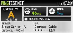

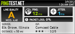

+BudMan MVC Posted March 9, 2012 MVC Share Posted March 9, 2012 40-50 is just terrible, what do you get to your ISP gateway directly? example PING 24.13.xxx.xxx (24.13.xxx.xxx): 56 data bytes 64 bytes from 24.13.xxx.xxx: icmp_seq=0 ttl=255 time=9.514 ms 64 bytes from 24.13.xxx.xxx: icmp_seq=1 ttl=255 time=8.518 ms 64 bytes from 24.13.xxx.xxx: icmp_seq=2 ttl=255 time=9.711 ms 64 bytes from 24.13.xxx.xxx: icmp_seq=3 ttl=255 time=7.500 ms 64 bytes from 24.13.xxx.xxx: icmp_seq=4 ttl=255 time=9.372 ms 64 bytes from 24.13.xxx.xxx: icmp_seq=5 ttl=255 time=9.597 ms 64 bytes from 24.13.xxx.xxx: icmp_seq=6 ttl=255 time=9.688 ms Here is more like what you should be seeing to a server close to you. Shoot I can pick a server 400 miles away and get those kinds of numbers. Link to comment Share on other sites More sharing options...
