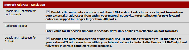

+BudMan MVC Posted March 26, 2012 MVC Share Posted March 26, 2012 If you trying to access your public IP from the private side to get reflected back in. This is call nat reflection or loopback forwarding, and not all routers support it. And to be honest is not a good thing to use. As stated to test a forward, you need to be external -- unless you are sure your router supports nat reflection, which many do not. Link to comment Share on other sites More sharing options...

+BudMan MVC Posted March 26, 2012 MVC Share Posted March 26, 2012 "haven't even seen it on my home's DD-WRT" like I said it can be called a few different things loopback forwarding, nat loopback, nat redirection, nat reflection, etc. dd-wrt supports it for sure http://www.dd-wrt.com/wiki/index.php/Port_Forwarding_Troubleshooting#Test_Loopback Uncheck Filter WAN NAT Redirection (it is by default) which means loopback will be allowed. Many routers do not support it, and to be honest there is no reason to support it. As stated the normal way to do what you want is via name resolution. While inside you resolve to local IP, if outside then you would resolve public. What program would you be using that you would hardcode an IP?? That is just asking for issue down the line to be sure!!! Whenever possible you should use FQDN vs direct IP. Link to comment Share on other sites More sharing options...
