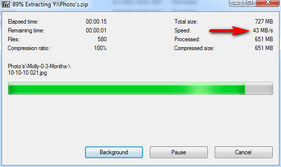

0 +BudMan MVC Posted April 10, 2012 MVC Share Posted April 10, 2012 Sorry but I have tested that software since XP -- even with XP it never did faster anything... Not saying it does not have some useful file copy features, but its claim to fame is that your speeds will be faster -- which every single test I have with that software has not once shown this. Multiple computers - never even 1mbps faster.. Sorry if you make **** up about about your product - its CRAP! As to your extraction issue -- what are you extracting so I can try and duplicate. is it lots of tiny files in a 7z, or large file compressed? I just did a simple test of lots of pics in a zip file that I extracted with 7z and not seeing any 20mbps limit. As to moving large amounts of files - I have always just used robocopy from the cmd line -- as to feature set, blows teracopy away that is for damn sure. And guess what it never claimed to make your copies faster ;) So it don't make bold face lies! BTW.. was reading a thread about the new N40L that I just setup as to file speeds and came across this little tool for testing. NAS performance tester 1.4 http://www.808.dk/?nastester Running warmup... Running a 400MB file write on drive Y: 5 times... Iteration 1: 46.94 MB/sec Iteration 2: 79.36 MB/sec Iteration 3: 75.94 MB/sec Iteration 4: 61.99 MB/sec Iteration 5: 64.91 MB/sec ------------------------------ Average (W): 65.83 MB/sec ------------------------------ Running a 400MB file read on drive Y: 5 times... Iteration 1: 85.30 MB/sec Iteration 2: 87.50 MB/sec Iteration 3: 87.33 MB/sec Iteration 4: 85.27 MB/sec Iteration 5: 90.33 MB/sec ------------------------------ Average ®: 87.15 MB/sec ------------------------------ These are the speeds I am getting over my gig network to and from a VM, and that 7z test I did was from a drive shared off a VM running on esxi 5u1 off a little $270 N40L box.. You sure don't need expensive hardware these days to get decent network speeds. Link to comment Share on other sites More sharing options...
0 UseLess Posted April 10, 2012 Author Share Posted April 10, 2012 @watchthisspace: brilliant idea! Checking out the performance monitor while extracting! @budman: yeah their speed claim WAS right, but isnt anymore =P you're right on that one. Aww haha way to rub it in, your 7zip loves you more! Huzzah, you're all brilliant! =) Not sure why, but your screenie made me think of admin rights. Run as admin = full speed! Guess UAC doesn't play nice with Win7 on my machine. Any ideas why running without admin rights would restrict speed? Link to comment Share on other sites More sharing options...
