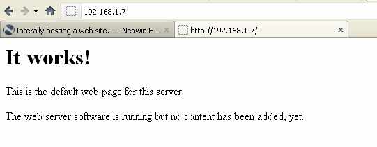

Here I just fired up apache on my test linux box. apt-get install apache2
And there you go access of site via IP with no redirects.. So either you messed with the config of apache, edited the .htaccess file or the page your loading from the site is doing the redirect.

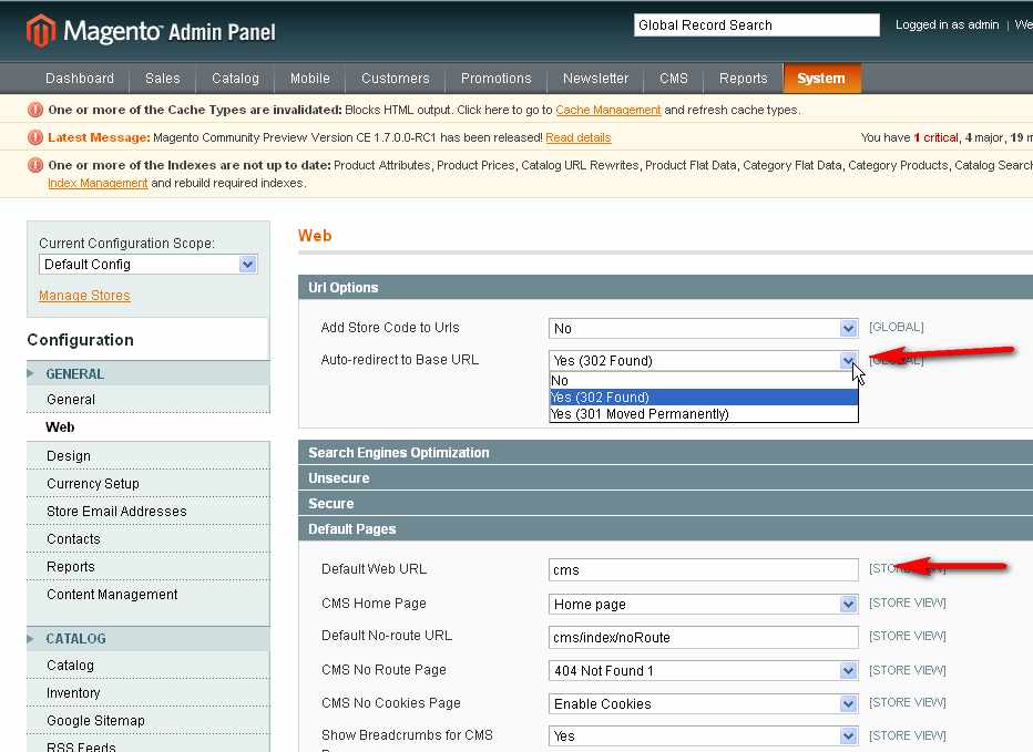

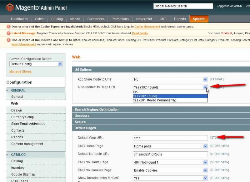

So you setup this package http://www.magentocommerce.com/
Look at the index.html file or index.php file, etc. in you c:/test folder-- many of these canned sites have redirects built into them.. So yeah you hit http://ipaddress and right away your redirected to http://www.test.dev which no is not going to work, so nothing is going to be shown in the browser.
I have not used this application so would have to install it to see what it does out of the box.
edit: Ok just hit up a demo admin page, and yeah this could be an issue
post-14624-0-70314700-1334162753_thumb.j
It defaults to redirect vs no, and then there is also a setting in here that redirects to base url if cookies disabled, etc..
So your redirect is to www.test.dev that could be your problem right there, if the client can not resolve that.
So you need to either disable this redirection stuff, change it to IP address. Or use your host file, or setup dns.

There was something in there that stated if cookies not working, redirect to base url. So yeah if trying to set cookie for localhost, which browser refuses -- if your base url is www.test.dev then sure would explain what is happening.

Fix up your redirect stuff in the admin page of that web app and you should be able to use http://ipaddress vs host name, etc. Which should remove your need for host file entries or dns.
