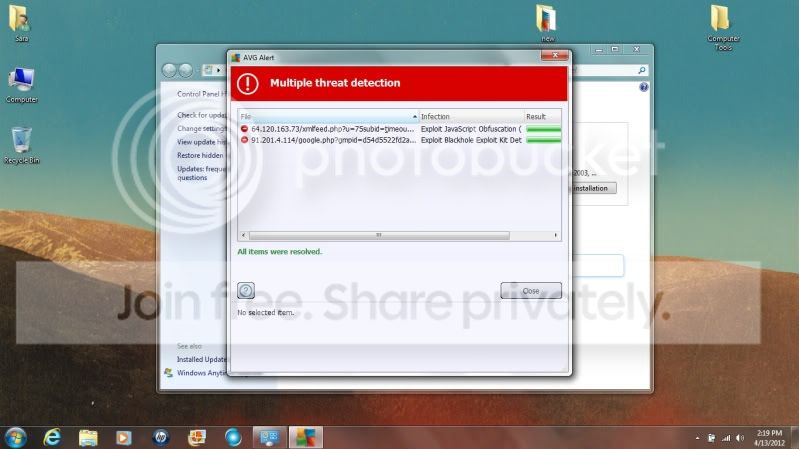

A friend of mine brought over his new HP laptop and wanted me to fix his virus issue. so after a few attempts and different programs finding more and more crap even after it has all removed I decided to just run the pre install image and restore the machine. He didnt have anything on it anyways.
So I did that loaded up AVG. And left it doing windows updates on my bench, When i came bake in to look at it the thing was already infected.
AVG as well as Microsoft's own utility found infections. Nothing else in installed other than Firefox.
I am redoing it all jst to make sure. But what gives? what do you all make mf that.
And check out some of the file names in this screen capture.

why is everybody talking about windows keys anyways? why do topics always go so far away from where they started. I have have been fixing computers for over 20 years. I have used the OEM key numbers stuck on the side of computers to re install windows xp for years. I have never had to do it with windows 7.
But this is not what this post was about. I was trying to figure out how it got infected with a virus so quickly? was it from the HP ISO recovery partition or from a windows update. They were the only 2 things put on the computer at the time.
SO for get about product keys. Save that for somebody else post.
This last screen shot happend while it was in the middle of doing windows updates..

You're infected with a bootrec virus...boot loader is infected before you even hit Windows.
http://support.kaspe.../?qid=208283363
Run TDSS Killer, let it cure it via restart. Run it again, should be good to go when it comes back clean. I wouldn't wipe it again, but I would change any passwords that you may have typed in while that machine was infected.
Doesn't matter how many times you restore it, or how many times you install with OEM key until the bootrec is cleaned it's going to keep doing it.

Hello,
The computer was infected by the Black Hole Exploit Kit, which, as the name implies, is a framework which allows criminals to attempt to exploit multiple vulnerablities on a computer in the hope that one of them will be unpatched and allow their malicious code to run. The kit might deliver various exploits for the operating system, the web browser, plugins like Adobe Flash, Acrobat Reader, Java and so forth.
When a computer ships from the manufacturer, the operating system software image on it is typically months out of date with respect to security updates and patches, and preloaded software like Adobe Reader could be an entire version behind. This is why it is critical when one first receives a new computer to plug it into a NAT'ed connection (which breaks the direct connection between the public Internet and the computer) and run through all of the update services offered by Microsoft, the computer manufacturer and installed third-party software (including security software like antivirus) before one starts going out and surfing the net on the computer.
