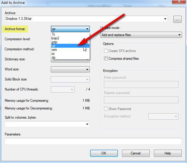

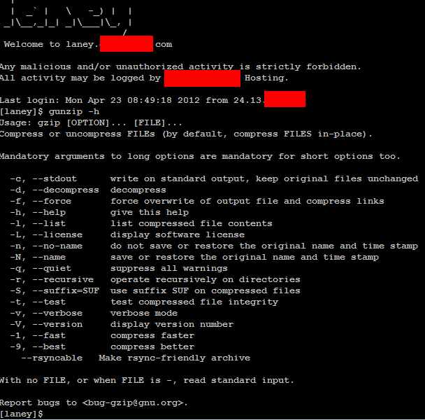

0 +BudMan MVC Posted April 23, 2012 MVC Share Posted April 23, 2012 can you add stuff to this remote ssh box? So you can use what you want? But zip should be a given that should there. here is my remote host shell account - it has an unzip support. You normally can create .tar file on windows as well with pretty much any zip program. Here 7zip shows it can pack .tar and gzip, etc. Packing / unpacking: 7z, XZ, BZIP2, GZIP, TAR, ZIP and WIM So you should be able to create with 7zip and then expand it on your host. Link to comment Share on other sites More sharing options...
0 htcz Posted April 24, 2012 Author Share Posted April 24, 2012 I couldnt find a way to create a tar in 7zip I am using your advice of zipping it all up and extracting it server side. But today the transfer is painfully slow :( The other day it took 15 minutes. Today 45 mins :( Link to comment Share on other sites More sharing options...

0 +BudMan MVC Posted April 24, 2012 MVC Share Posted April 24, 2012 "I couldnt find a way to create a tar in 7zip" But you don't have to tar it, you could just gzip it. or bzip2 is another one that is most likely on any linux distro. But you can create your tar if you want, and then gzip the tar so you end up with tar.gz, etc.. Link to comment Share on other sites More sharing options...
