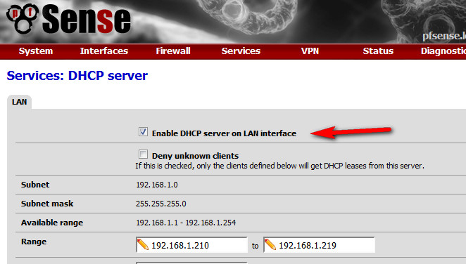

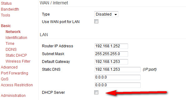

+BudMan MVC Posted April 26, 2012 MVC Share Posted April 26, 2012 Saw your PM.. Here is what I would suggest -- throw the freaking apple product out the window ;) Come on they are suppose to just work right!! So where is turn of dhcp server checkbox/radiobutton - every other router on the planet its 1 click to enable/disable dhcp server! They design their products for their userbase, which are complete and utter moronic sheep that stand in line to spend 4x what the hardware and software is worth! example I could post example of 15 other router models where its the same thing -- click on dhcp, click off dhcp server. here is my router They dumb down the interface to a point that its completely and utterly pathetic!! This is just my person point of view and trying to help my sister in law with her apple - I told her up front, don't buy it.. But its so easy to use she says.. Then why and the F are you having to ask me so many questions?? Why do I have to always drop to a command line on your mac to get anything done? ;) At least from the command line its pretty much like any other linux distro.. Which if you would just use that -- than I could help you. You can not even create shortcuts to software easy on that freaking crap! I would love to help, with any other router is a NO BRAINER to use it as just an accesspoint... You turn off dhcp, you plug into one of the lan ports - shazam its a accesspoint. How you do it on a airport I have no idea -- Good Luck! /my antiapple rant of the month ;) BTW -- I love to have an ipad to play with.. But sorry not going to spend the money when I can get 3x the hardware for 1/2 the cost ;) Link to comment Share on other sites More sharing options...
