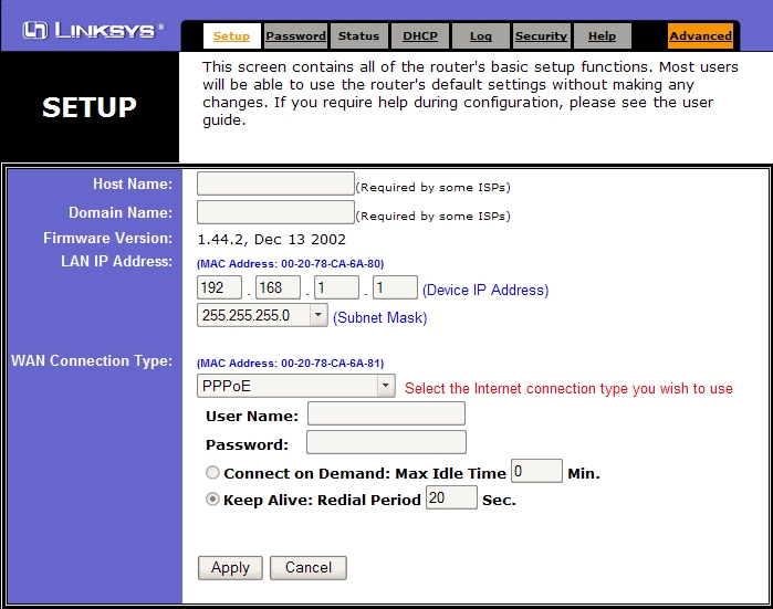

Magister Posted October 14, 2003 Share Posted October 14, 2003 Most likely it's the "Keep Alive" setting.. I had the same problem with mine (using DSL service) until I set the "Max Idle Time" and the Keep Alive settings. Never had the problem since. Here's a screen snap of the settings that work for my connection, (your milage may vary... :p ) Link to comment Share on other sites More sharing options...
Jish Posted October 14, 2003 Author Share Posted October 14, 2003 1) That firmware update does not work for my router. The latest version is... http://www.linksys.com/download/firmware.asp?fwid=183 2) That screenshot looks totally different then mine. Link to comment Share on other sites More sharing options...
