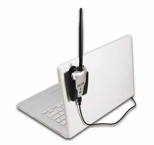

Thats not a booster - thats just a wireless card with a better antenna.. Looks a lot like a typical alfa card with suction cup holder.

Look at the card in the picture from their site - that sure looks like a alfa card too me.. Which are good cards.
But your not suppose to use it at the same time as your built in card, atleast not connected to the same wireless network, etc.
Disable your built in card, and just use the new wireless card you purchased -- again its not a BOOSTER, that is just their marketing nonsense.
What is the model number on the card? From the shape I would say its a alfa card.

It is not an Alpha card.
Bottom label reads: WiFi x10, 802.11b/g High Power, Wireless USB Adapter, a serial number, wifix10.com, Made in China (I'm shocked :s ).
