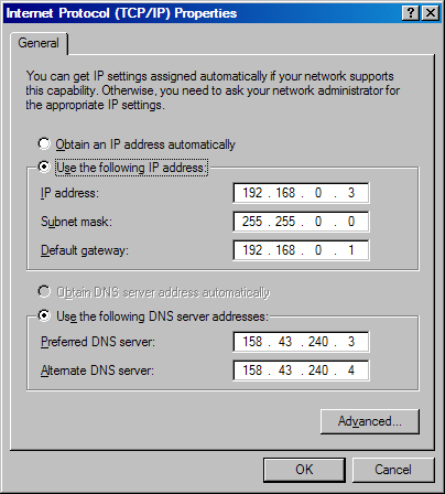

AshMan Posted October 13, 2003 Author Share Posted October 13, 2003 And here are the other settings. Note, they have not changed. Also setting it up to get the DNS and IP automatically does not seem to work. Link to comment Share on other sites More sharing options...
UnaBonger Posted October 13, 2003 Share Posted October 13, 2003 You sure you have the right subnet mask? Event logs say anything? when in doubt try uninstalling the NIC from windows, reboot and let it re-install it... Link to comment Share on other sites More sharing options...

snocked Posted October 14, 2003 Share Posted October 14, 2003 subnet masks for a class c should be 255.255.255.0 Link to comment Share on other sites More sharing options...

UnaBonger Posted October 14, 2003 Share Posted October 14, 2003 Oh, you never mentioned that it could see the other machines... Thats a whole different thing... Make sure you have the correct DNS settings. Also, which router are you using? One that has built in DHCP functionality? Try using that instead of manuallly assigning IP's, You'll find that's much easier to work with and troubleshoot networking problems. Link to comment Share on other sites More sharing options...
