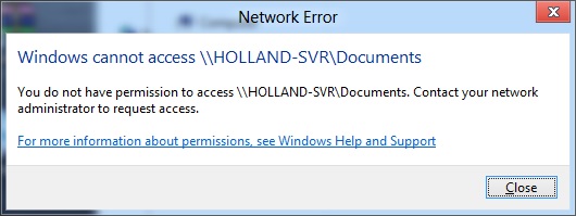

Hi guys,
I'm probably being an idiot but after installing win8 and mapping all my network drives and rebooting I'm now encountering this error.
[Window Title]
Network Error
[Main Instruction]
Windows cannot access \\HOLLAND-SVR\Documents
[Content]
You do not have permission to access \\HOLLAND-SVR\Documents. Contact your network administrator to request access.
For more information about permissions, see Windows Help and Support
[Close]
My server is set up correctly and was working fine before. It would usually come up with a dialogue asking for username and password but NOTHING appears except this message.
Many thanks..
Alex

DJGM    250
Hi guys,
index.php?app=core&module=attach&section=attach&attach_rel_module=post&attach_id=312125
Many thanks..
Alex
That is one of the error messages I absolutely HATE in Windows. It happens to me as well occasionally.
Makes my blood boil ... like how dare you say I don't have permission to access my own files on one
of my computers. Contact my network administrator, really? It's my network, I AM the administrator!
So essentially, I have to actually contact myself to resolve the issue!
