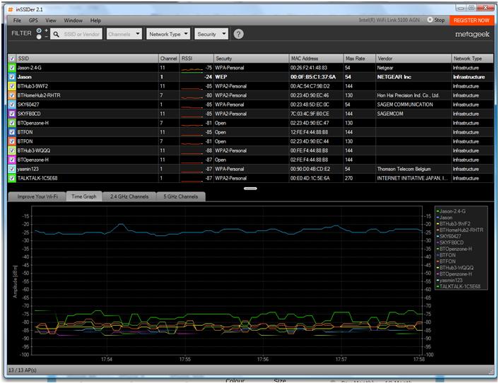

cybertimber2008 Posted June 4, 2012 Share Posted June 4, 2012 Can you use InSSIDer on your wireless laptop so we can see the two APs and their details? I wonder if it's a channel conflict. Link to comment Share on other sites More sharing options...
JasonC Posted June 4, 2012 Author Share Posted June 4, 2012 OK, upgraded to the latest drivers, made a slight improvement, internet seemed to load a page faster, went on to youtube and it loaded the first 24 seconds of a video, then played a little bit more, it didnt stop as much as it did. but after around 45 seconds it will just stop altogether. Tried downloading inssider, while connected to the 2nd wireless network, the file size was about 1.71mb, and I was getting between 15 - 18kbps,, while if I was hardwired, or connected to the first wireless, I'd be getting anywhere upto 700kbps. I went into device properties, and couldn't see anywhere to make all the settings default? Having a few issues changing the MTU, i used the command "netsh interface ipv4 set subinterface "Wireless Network Connection" mtu=1458 store=persistent" but got an error message saying "the requested operation requires elevation". I also installed the inssider, but unsure exactly what im looking for, It lists about 11 wireless networks. I don't know what to do :/ Link to comment Share on other sites More sharing options...
sc302 Veteran Posted June 4, 2012 Veteran Share Posted June 4, 2012 Give us a screenshot of inssider. We can help from there. With that many networks probably some interference from one of them. We can help with that. Try plugging directly into router2 and check speeds as well. Link to comment Share on other sites More sharing options...
JasonC Posted June 4, 2012 Author Share Posted June 4, 2012 If I plug directly into router 2, I get full download speed, not an issue there. Both networks are on differnet channels. The Jason 2.4-G network is the router1, and Jason is router2. Cheers Link to comment Share on other sites More sharing options...
c.grz Posted June 4, 2012 Share Posted June 4, 2012 You have 5 other routers on Channel 11. Tried changing it to another channel that isn't 1, 7 or 11? Link to comment Share on other sites More sharing options...
JasonC Posted June 4, 2012 Author Share Posted June 4, 2012 Tried changing the channels, no effect, also, deleted the network adapter, restarted and reinstalled it, still didn't make any difference. Link to comment Share on other sites More sharing options...
