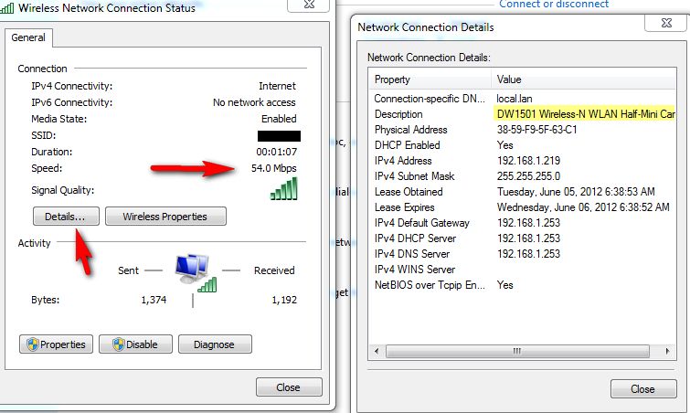

+BudMan MVC Posted June 5, 2012 MVC Share Posted June 5, 2012 Wireless can only actually talk to 1 device at a time. If you have devices connecting at B or G, then yeah they will slow down the network to those speeds vs if all the devices were connecting at N. I would have to assume every thing is capable of atleast G, so I would turn off B for sure! You don't know if your wireless interface is bult in, a usb dongle or pci card?? Come on?? Are you using a laptop? If so what is the make and model? Does it have a USB thing sticking out the side you use to connect to wireless? Are you on a desktop with a card you installed or came with the thing that has little antennas off of itor cable that goes to an antenna? See where you see signal strength click that and you will get status of the network your connected too, like at what speed your connected the description of the wireless card your using. That is if your using windows 7 built in supplicant, maybe your using one from the maker of your card? even better, if you go to an eleveated cmd prompt and use netsh wlan, then show interfaces netsh wlan>show interfaces There is 1 interface on the system: Name : Wireless Network Connection Description : DW1501 Wireless-N WLAN Half-Mini Card GUID : 737d5c79-2b15-4e24-87cf-6d4afff1c9db Physical address : 38:59:f9:5f:63:c1 State : connected SSID : snipped BSSID : 00:13:10:snipped Network type : Infrastructure Radio type : 802.11g Authentication : WPA2-Personal Cipher : CCMP Connection mode : Auto Connect Channel : 1 Receive rate (Mbps) : 54 Transmit rate (Mbps) : 54 Signal : 92% Profile : snipped then if you do show drivers netsh wlan>show drivers Interface name: Wireless Network Connection Driver : DW1501 Wireless-N WLAN Half-Mini Card Vendor : Broadcom Provider : Broadcom Date : 1/21/2010 Version : 5.60.48.35 INF file : C:\Windows\INF\oem14.inf Files : 5 total C:\Windows\system32\DRIVERS\BCMWL664.SYS C:\Windows\system32\bcmihvsrv64.dll C:\Windows\system32\bcmihvui64.dll C:\Windows\system32\drivers\vwifibus.sys C:\Windows\system32\bcmwlcoi.dll Type : Native Wi-Fi Driver Radio types supported : 802.11n 802.11g 802.11b FIPS 140-2 mode supported : Yes Hosted network supported : Yes Authentication and cipher supported in infrastructure mode: Open None Open WEP Shared None Shared WEP WPA2-Enterprise TKIP WPA2-Personal TKIP WPA2-Enterprise CCMP WPA2-Personal CCMP WPA2-Enterprise Vendor defined WPA2-Enterprise Vendor defined Vendor defined Vendor defined Vendor defined Vendor defined Vendor defined TKIP Vendor defined CCMP WPA-Enterprise TKIP WPA-Personal TKIP WPA-Enterprise CCMP WPA-Personal CCMP Authentication and cipher supported in ad-hoc mode: WPA2-Personal CCMP Open None Open WEP IHV service present : Yes IHV adapter OUI : [00 10 18], type: [00] IHV extensibility DLL path: C:\Windows\System32\bcmihvsrv64.dll IHV UI extensibility ClSID: {aaa6dee9-31b9-4f18-ab39-82ef9b06eb73} IHV diagnostics CLSID : {00000000-0000-0000-0000-000000000000} show all would give a full dump of your wireless settings - which might be very useful. That is if your using w7 or vista. So you have these other computers and devices connected to the same router. You sure someone is not just doing p2p? Or downloading something large? What speeds do they get? One wireless client moving a large chunk of data can kill the wireless for all the wireless clients. Its shared bandwidth!! Link to comment Share on other sites More sharing options...
