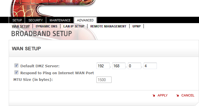

Elliot B. Posted June 7, 2012 Share Posted June 7, 2012 I have set a DMZ (I don't need a lecture thank you) on my router for my PC for 192.168.0.4. However, every day or two (it seems random), my PC changes the local IPv4 address! Sometimes it's 192.168.0.4, sometimes 192.168.0.5, sometimes 192.168.0.2 etc. How can I stop this from happening? It's probably related to my wireless printer or the parent's laptop or something. Link to comment Share on other sites More sharing options...

Elliot B. Posted June 7, 2012 Author Share Posted June 7, 2012 If you have a Linksys router or similar, you can just assign your computer an IP outside of the DHCP pool and it won't change anymore. Where should I look? This is what I see in Advanced: Link to comment Share on other sites More sharing options...
