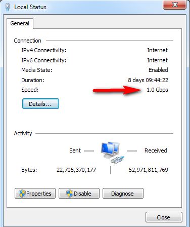

Tarvis123 Posted June 13, 2012 Author Share Posted June 13, 2012 Thanks budman, I will have to test and post the results these later this evening. I do know that the interfaces in the local area connection status window are showing 1.0 Gbps speeds like in your picture however. Link to comment Share on other sites More sharing options...

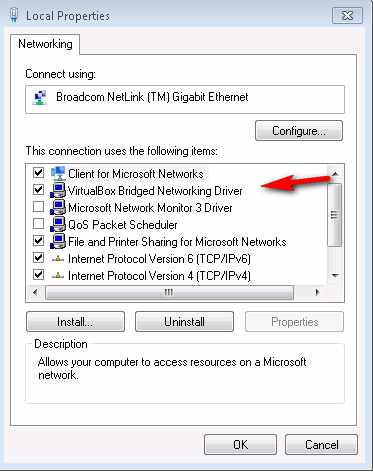

+BudMan MVC Posted June 13, 2012 MVC Share Posted June 13, 2012 So for grins make sure you unhook virtualbox/hamachi and cisco vpn hooks.. You should be able to see your hooks on the properties page.. See for example my virtualbox bridge hook. I would make sure nothing is hooked into the nic other than your tcip/ip and windows client and file and print sharing.. Uncheck everything else - you can always just check them back in one at a time once we are seeing normal gig speeds. The older virtualbox use to be a pretty big hit, but from my latest testing its not all that bad. And I am seeing over 800 with my iperf tests so more than enough for my needs. But before I do believe the hook use to cause my iperf tests to drop to under 600. At one point I even had a second nic being used to bridge my virtualbox into my network. I would make sure you set your mtu back to the default 1500. And look into the cisco vpn, I know it normally turns on a firewall by default and likes to change the mtu to 1300 I believe. Neither of which should account for such low speeds, but could cause a hit in the long run. Very interested in seeing the actual wire number tests and the netstat -s results. Link to comment Share on other sites More sharing options...
